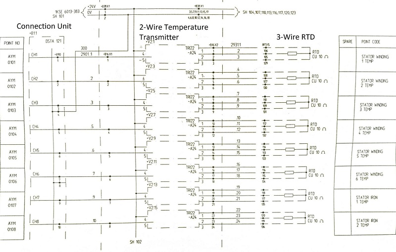

Figure 1 below shows the wiring scheme, outlining the 3-wire RTDs (right side) connected to the 2-wire transmitter (center column). The output of the transmitter, which is providing 4-20 mA, is further connected to the analog input card of the RTU/PLC (left side), labeled as a ‘connection unit.’
RTD connection diagram
Figure 1. Diagram of 3-wire RTD connections with 2-wire temperature transmitter. The output of the transmitter is connected via Connection Unit DSTA 121
The final connection (shown at the top of the diagram) is the transmitter power supply requirement, 8 to 36 VDC in this case.

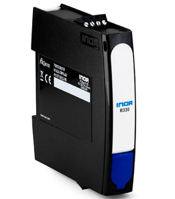

2-wire Universal IPAQ R330
The 3-wire PT100 RTD in our example will be connected to the universal transmitter IPAQ R330 by INOR. This is a modern digital temperature transmitter that supports 2-wire, 3-wire, and 4-wire sensor connections and is compatible with RTDs, thermocouples, and even other variable resistance devices as inputs. This universal transmitter can work with multiple types of RTDs, like Pt100, Ni100, Cu10, etc.
Temperature transmitter for RTD devices
Figure 2. 2-wire IPAQ R330 transmitter. Image used courtesy of INOR

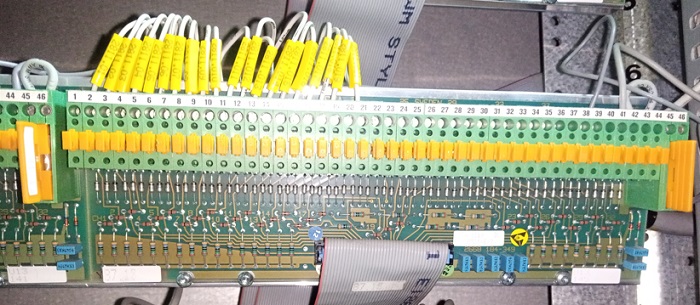

The 2-wire transmitter output is wired to the connection unit DSTA 120 for further processing and control (this is shown in Figure 3 below). The DSTA 120 connection unit is part of the process interface system and is used to bring the raw analog signals to the analog input boards in the control system.
The unit contains the terminal blocks of field wiring for incoming signals. All of the 32 channels are provided with voltage-limiting protective components and a shunt for current signals. The nominal signal range for voltage is +10 V and the current signal range is +20 mA. The 250 Ω shunt is normally used for the adoption of current signals on the connection unit.
RTD to analog connection unit
Figure 3. Connection Unit DSTA 120 is used for the termination of field wires

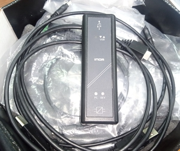

Many temperature transmitters can be configured using the proprietary software, allowing the user to set measurement range, output scaling, and select the sensor type. The transmitter configuration can be performed via a computer COM port connected directly by USB or through a protocol such as HART or Modbus.
USB to serial converter
Figure 4. USB converter to make a connection between PC and transmitter

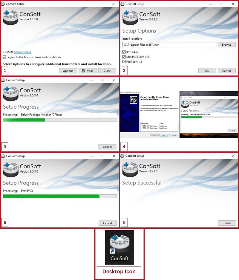

To connect and configure the transmitter, first install the ConSoft 3 software on the PC. The installation steps of ConSoft 3 software are given below:
Consoft software setup steps
Figure 5. ConSoft 3 software setup steps.

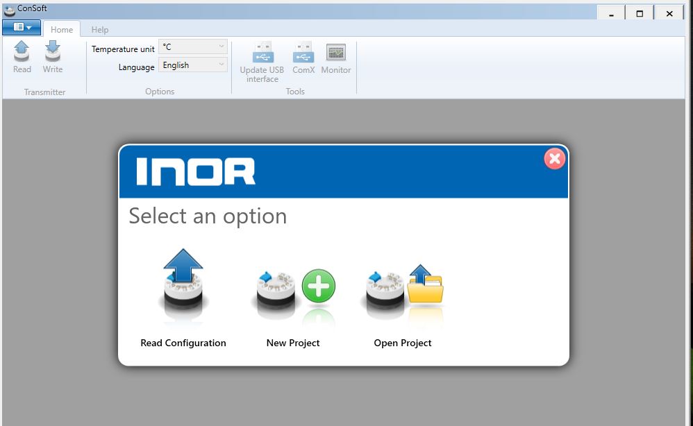

  1. The first step is to click on the Consoft icon, and a new popup window appears to choose the appropriate options as per requirement i.e. reading the configuration of the already configured transmitter, creating a new project, or opening an existing project.
    Setting up a new project

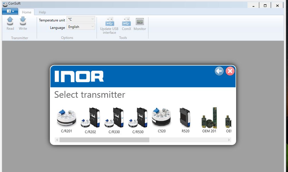

  2. The second step is to select the transmitter. This project uses the C/R330.
    Selecting the right device

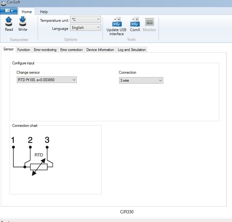

  3. Now, select the transmitter input, a 3-wire PT100 sensor in our case.
    Parameters for the RTD setup

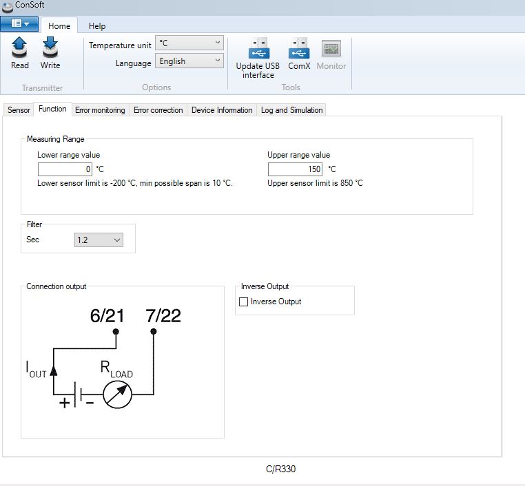

  4. Under the Function tab, input the measuring range from 0-150 °C.
    Parameters for temperature range

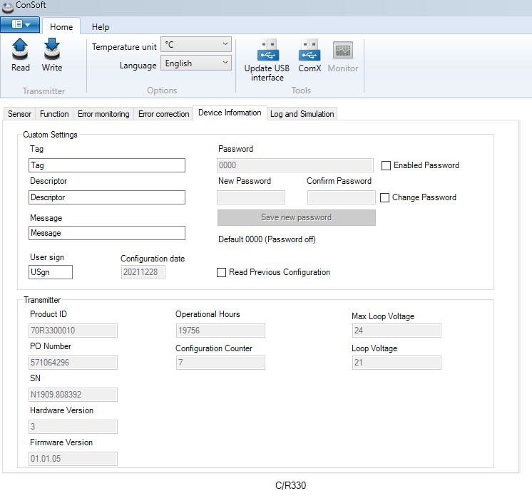

  5. The next tab shows the device information like operational hours, loop voltage, serial number, hardware and firmware version, etc.
    Transmitter device information

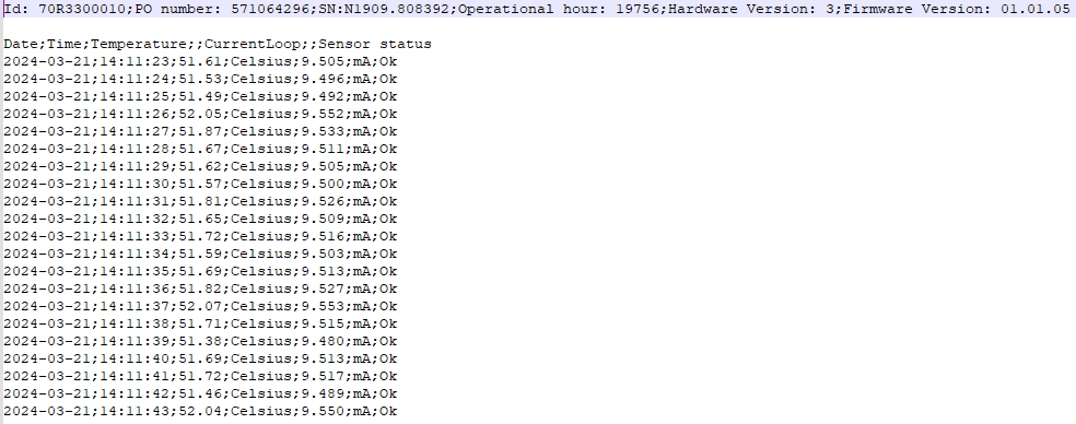

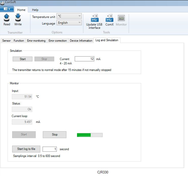

  6. Finally, we write the changes to the transmitter (in this case, we have a real-world transmitter and RTD actually connected). Open the last tab, which provides settings for data logging and simulation. Under the Monitor section area, the current temperature value is 51.54 °C, and the output is 9.497 mA.
    Monitoring device data from the transmitter
  7. We can log the live parameters and save them in a file in the .csv format by clicking the “Start log to file” button.
    Logging data from the RTD temperature transmitter
