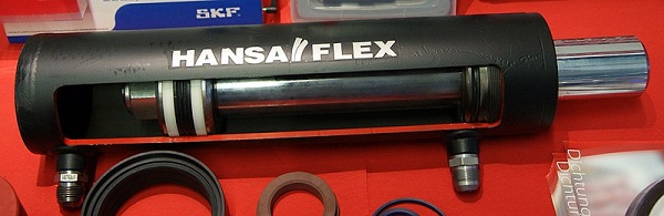

Inside view of a hydraulic cylinder
Figure 1. Cutaway view of a hydraulic cylinder. Image used courtesy of Wikipedia

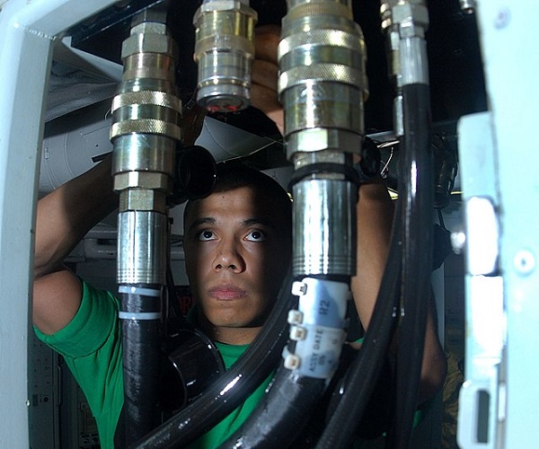

Technician inspecting hydraulic lines
Figure 2. Technician repairing hydraulic hoses and fittings. Image used courtesy of Wikipedia

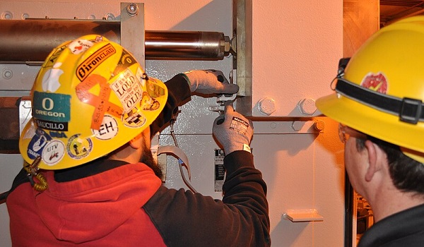

Technician tuning hydraulic system components
Figure 3. Technicians adjusting hydraulic assembly brackets. Image used courtesy of Wikipedia
