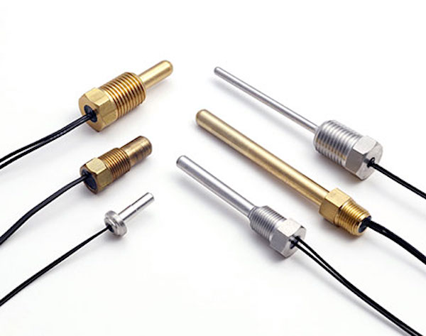

Figure 1. Several commercial RTD probes; the RTD is inside these metal housings. Image used courtesy of EI-Sensor
A resistance temperature detector, or resistance temperature device (both of which are abbreviated RTD), is a way to measure the temperature of a substance using this effect. As the temperature changes, the resistance of a thin wire increases. Figure 1 shows several commercial, threaded RTD probes.

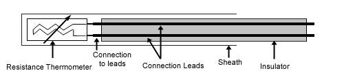

RTD sensor internal diagram
Figure 2. Diagram of a resistance temperature detector (RTD). Image used courtesy of Psanderson
It also must have a predictable resistance with a change in temperature. This change in resistance is described by a linear equation. For example, one of the most common RTD on the market is the “Pt100,” which stands for a platinum wire with 100 Ω of resistance at 0 °C. This RTD can also be described by the equation:

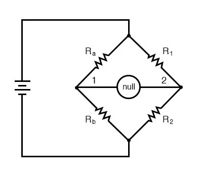

While the resistance change can be measured with a multimeter, a much more common way to measure a resistance change is to use a Wheatstone Bridge circuit. Figure 3 shows a Wheatstone Bridge for reference. The RTD acts as an adjustable resistor, and thus, could replace Rx. As the resistance changes, the voltage measured across “null” will also change.
A balanced Wheatstone Bridge circuit
Figure 3. Wheatstone Bridge.
One could use their knowledge of circuit analysis, and the linear equation for the RTD to calculate the temperature change for a given voltage change. A more common way to determine the temperature is through a calibration procedure.
