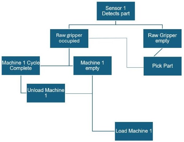

So, start counting! The best way I found to stay organized is to start with a flowchart of your system and work forward, filling in the blanks. This gives you the best opportunity to find all your currently scoped inputs and outputs, displaying them in a logical sequence. As you are counting, document them in a spreadsheet, or however you deem fit, but keep them organized and separated based on signal type.
Flowchart for an automation work cell
Figure 1. Example of an automation flow chart. Image used courtesy of the author

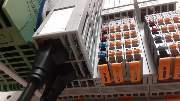

Network cables on a Phoenix Contact PLCnext
Figure 2. Networking cables on an industrial controller. Image used courtesy of the Control.com engineering team
The good news is that including pretty much any network is a step in the right direction for minimizing the size of your electrical cabinet and reducing the amount of wiring for your system. Field busses are also typically much easier to diagnose and troubleshoot compared to large hard-wired systems. Analog and digital signals can also be transmitted without the use of different modules. Network communication can connect to dozens of nodes as well, for example, Ethernet/IP can connect up to 256 nodes.
The bad news is that 9 times out of 10, the choice of field bus communication will be dictated by the compatibility of the devices that you are installing in your system. You will have to verify the documentation of your devices to determine which protocol will work. For example, Rockwell Automation devices will most likely be controlled through an Ethernet/IP as they actually developed that technology, while a Siemens device will be using PROFIBUS DP/PA. Typical devices will have multiple protocol capabilities or will have a different drive that is compatible with the type of field bus you wish to use.
The advantages of using fieldbus devices vary from application to application, but it is entirely worth using in almost any application. For example, with I/O link devices, copy machines can be set up quickly due to configurations being able to be stored internally and devices can be replaced without programming making repairs quicker. Statuses of machines and devices can be viewed remotely with live feedback. Also, if you’re anything like me, minimizing the overall wiring in any system makes it look cleaner as well.

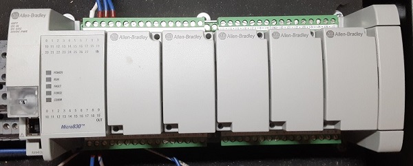

Rockwell Micro 830 PLC
Figure 3. Allen-Bradley Micro830 series PLC. Image used courtesy of the Control.com engineering team
Essentially, fixed PLCs come with a predetermined number of inputs and outputs. Most of the time, I/O will not be able to be extended. I/O for motion will also have to be predetermined as most fixed PLCs will only allow for the connection of variable frequency drives (VFD) or only allow a predetermined number of axes to be connected. Most fixed PLCs will only allow the connection to specific HMIs.
Fixed PLCs tend to be much cheaper than their modular counterparts, although every generation of fixed PLC seems to incorporate a wider range of I/O expandability and adaptability with other equipment.

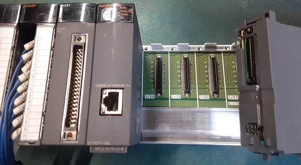

Modular Mitsubishi PLC
Figure 4. A Mitsubishi modular controller with a backplane and removable modules. Image used courtesy of the Control.com engineering team
Modular PLCs allow for expansion using modules. These modules can be used to support a wide variety of I/O, power supplies, or even communication switches. These are the most convenient when it comes to the expansion of systems. It makes complicated systems easier in the sense that an integrator can include a variety of relay, transistor, or analog signals with just the addition of a simple module.
