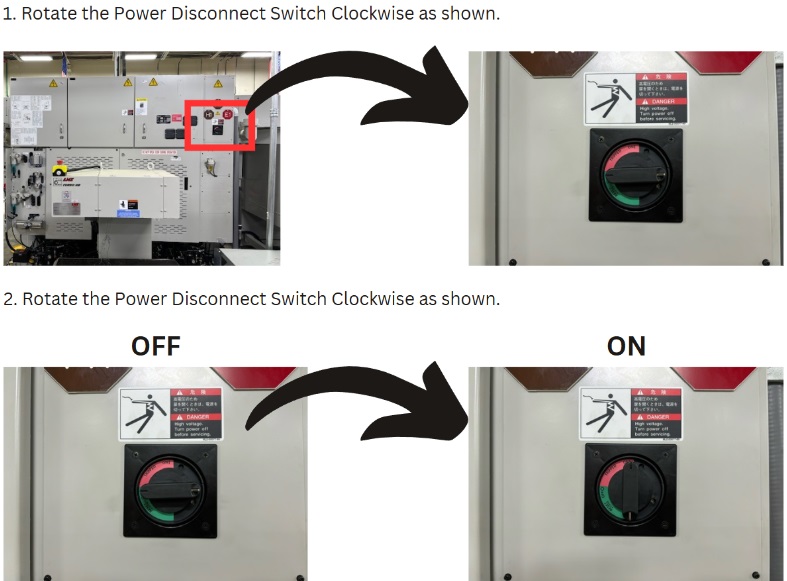

Now some of you may read this list and think, “Really? You need to explain the process for powering a machine ON and OFF?” Yes, there needs to be a procedure for everything! It also needs to be written in a way that everyone can understand.
As the local expert in the initial design of the automation system, it’s your job to keep everyone safe and allow everyone to understand what you’re saying. My recommendation is to try and break down your work instructions in ‘Barney’ style.
Step-by-step tutorial guide example
Figure 2. Image is used to depict a simple and easy-to-understand instruction set. Image used courtesy of the author
Please ensure that work instructions are clear and brief. If you find yourself frequently being asked about a specific task, please develop a work instruction for it. Make the instructions easily accessible and place them as close to the machine as possible. This can be accomplished by using a three-ring binder with tabs for each task, keeping a laptop or desktop computer nearby with the instructions loaded, or having the instructions readily available in your HMI.
