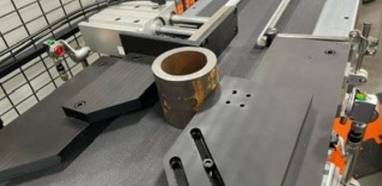

Figure 1. Part detection with a through-beam photoelectric sensor awaiting a machine tending application. Image used courtesy of the author

These extremely common, versatile sensors detect the presence or distance of an object by transferring light from a transmitter to a receiver, which may be in separate housings or combined into one compact sensor. There are three types of photoelectric sensors: through-beam, retro-reflective, and diffuse-reflective.
Figure 5. Photoelectric sensors can be used for a wide variety of positioning applications in automation, such as palletizing or color sorting. Images used courtesy of Leuze
Through-beam sensors require separate transmitter and receiver units. The transmitter sends a beam of light to a receiver, and when an object moves in front of the light, the receiver sends an output signal. These sensors have the longest sensing distances, some exceeding 20 meters, but through-beam sensors also require twice the wiring.
