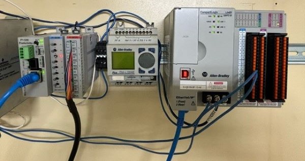

Bench Testing
Bench testing your automation cell can be extremely beneficial as it allows you to test the entire cell or specific components with uncertain parameters. Typically for my setup, I will test specific components rather than the entire cell. Depending on your company, shop floor space is a valuable resource that is hard to come by, and bench testing may even be a luxury to some that can’t be afforded.
Bench test for an automation system
Figure 1. Bench test setups do not need to be extravagant; remember that you are just testing. Image used courtesy of the author
Ideally, you will need a space that is either permanently set up with a control cabinet or a mobile station that can be easily hooked up to power and air and set up under “ideal” circumstances. This way you can set up and prove out projects with minimal cost, and an initial reduction in environmental variables.
The cells that I commission are typically much too large to bench test the entire assembly at once, so I test the individual components, like gauging, small assembly machines, in-house gantries, etc. Proving out the individual components allows for a swift integration into the entire machine, and reduces my overall time debugging the system.

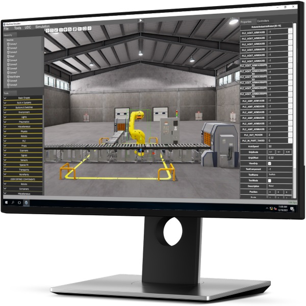

Simulation/Emulation Software
Simulation software for a robotics cell
Figure 2. Easy PLC simulation software uses drag-and-drop components to allow the programmer to easily set up a virtual machine for testing. Image used courtesy of Nirtec
Simulation software, such as EasyPLC from Nirtec, is a valuable tool for testing your PLC program. This software allows you to replicate your entire complex mechanical system using drag-and-drop components. It also enables you to test your I/O and PLC programming before your system is even built. The simulation software is compatible with a variety of automation software, including Siemens TIA Portal, Rockwell Studio 5000, Codesys, and many others. The main advantage is that it reduces the time necessary to debug your system when you first start it up.
Some software, like GX Works from Mitsubishi, contain a built-in simulation environment that can debug some initial challenges before comissioning. There are not a whole lot of effective PLC simulators on the market that work independently from both commercial hardware and software, like for a new learner getting acquainted with PLCs.

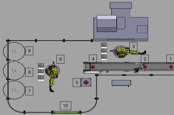

Machine tending robotics workcell
Figure 3. Machine tending cell. Image used courtesy of the author
When starting a system for the first time, it's important not to go full blast and try to watch everything all at once. Instead, start at the beginning of your system, work forward, and test everything. In Figure 3, I would begin by testing any possible condition that may occur at position 1, then move on to position 2, and so on.
Please keep the following information in mind:
At each position, consider all potential scenarios that may arise. For instance, position 2 is utilized to prepare a part for the robot at position 3 to load into the machine. There is a solitary sensor that sends a signal to the robot indicating the presence of a part. I would inquire about the following:
  • Can there be multiple components in this position at the same time?
  • Does the robot respond appropriately when the sensor is triggered?
  • Does the signal interfere with the robot at an inappropriate time?
  • Do multiple parts in the position cause a part to crash?
  • Does the conveyor continuously running cause parts to shift out of position?
Once you have questions, test scenarios at each position to debug your system systematically and prevent interference from other processes.
