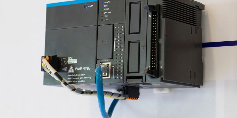

Networked PLC
Figure 1. Automation equipment relies heavily on high-speed networking cables. Image used courtesy of Canva

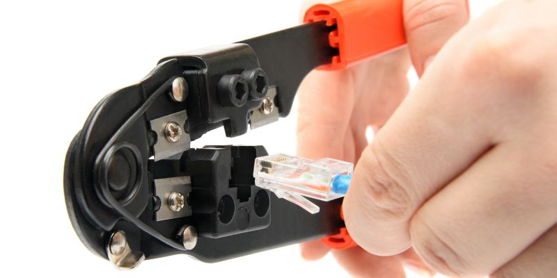

When installing a new automation system, invest in a good set of tools for cutting, stripping, and crimping Ethernet cables. Cables can be cut to the proper length, minimizing tripping and snagging hazards, while still allowing some properly-placed slack for system configurations.
RJ crimper tool
Figure 2. The ends of network cables rely on specialized registered jack (RJ) crimpers. Image used courtesy of Canva

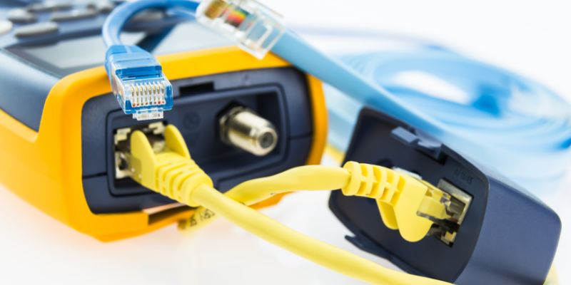

Cable tester
Figure 3. Network testers can easily identify cable types, lengths, speed capacities, and even failures. Image used courtesy of Canva
