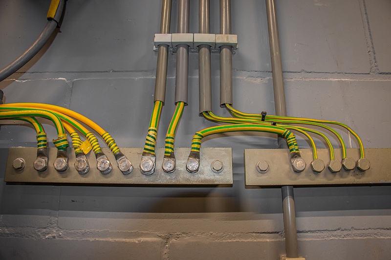

It’s almost always safe to assume that a green or bare copper ground wire will be interconnected between circuits and equipment inside every properly wired facility.
These ground wires might be contained in the plugs, just like the round third prong on a household AC receptacle. In some other cases, permanent wires will be ‘bonded’ to control panels and metal equipment structures inside industrial buildings.
The reason for this ever-present connection is to ensure that if any time, for any reason, a ‘hot’ energized wire becomes frayed, loose, or broken and touches a metal surface, the current immediately has a path back to the electrical source panel. This current will only be present in the ground wire if there is a fault since that hot wire isn’t supposed to touch the appliance under normal conditions. For this reason, it is called ‘fault current.’

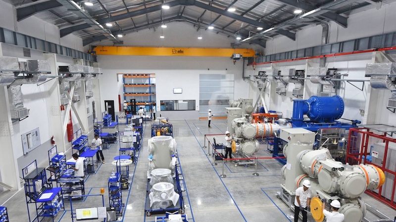

Figure 2. One of ABB's gas-insulated switchgear facilities is designed for a reliable power supply. This is one example of a facility where grounding and control wiring is especially important. Image used courtesy of ABB
If we could ensure that no fault current could ever appear, then the ground wire would not be necessary, just expensive. In reality, fault current is rare, so the ground wire isn’t used very often. When it is needed, it can save lives.

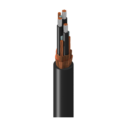

To ensure minimum extra resistance, the ground wire should be at least as large as the supply and return conductors. In most cases, manufacturer specs will provide guidance on a ground conductor; not only the size and material of the wire, but the exact procedures for bonding the wire to the metal as well.
Figure 3. A conductor used in these specific grounding applications. Image used courtesy of Belden
