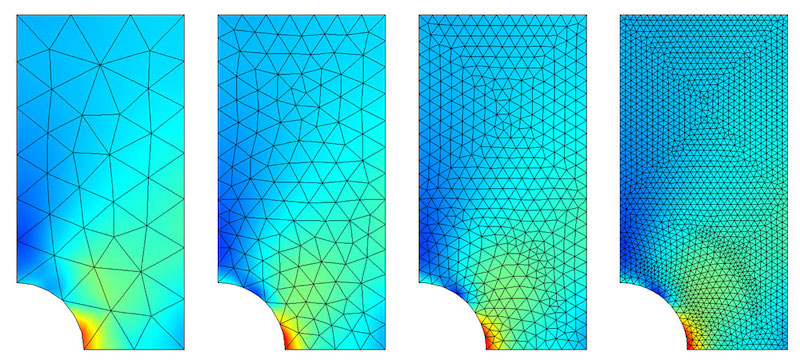

The pieces that FEA creates are called elements, and the total number of elements forms a mesh. The user can manually or algorithmically alter the mesh density based on the complexity of the model by increasing mesh density on joints, curves, or important areas within the model. Generally, it is good practice to begin with a coarse mesh density to give a rough understanding of the key points in the model where further mesh refinement can be done.
Depending on the model’s size, there could be hundreds, thousands, or millions of elements, increasing the simulation time from a couple of minutes to multiple days, depending on the computing power available. A proper understanding of meshing and mesh refinement can save hundreds of hours of computing time.
Mesh density FEA
Figure 1. Visualization of increasing mesh density on a steel plate. Image used courtesy of Comsol

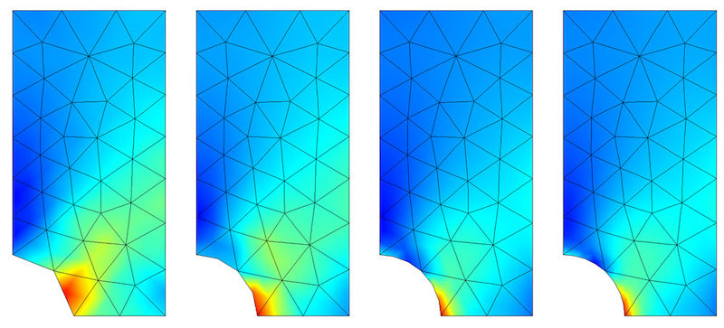

Adaptive meshing FEA
Figure 2. Visualization of local adaptive meshing. Concentrating the mesh density around the area of highest stresses. Image used courtesy of Comsol

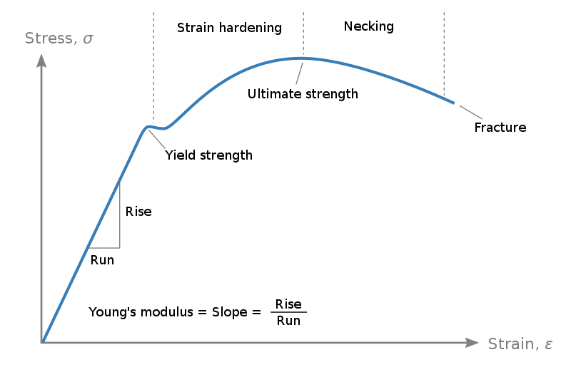

Small deformations mean that the material resides within the linear portion of the stress-strain curve (following the material's elastic modulus). This means that the material remains in its elastic state, does not experience any plastic deformation, and deflection can be calculated using Hooke’s Law
Stress strain curve for plastic and elastic deformation
Figure 3. Stress vs. strain curve, highlighting the linear behavior of a material until reaching the yield strength point; once beyond, the material begins to behave nonlinearly. Image used courtesy of Nicoguaro
When visualized in a curve, the software, unless otherwise specified, assumes the material continues linearly without yielding or plastically deforming, which can result in massive simulation errors. As an object or model moves throughout a simulation, the boundary conditions can change. For example, a cantilever beam close to the ground might bend until it touches the ground, resulting in a new set of boundary conditions.
