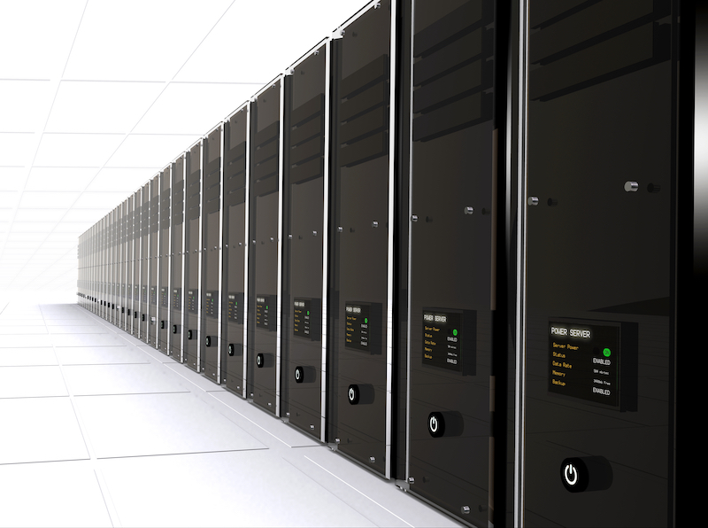

Office networks consist of individual devices (PCs, laptops, etc.). The network will operate even when one PC is not switched on or nobody is logged on. PCs do not communicate with each other, only with servers, databases, printers, and the like.
Figure 1. A PC server room.

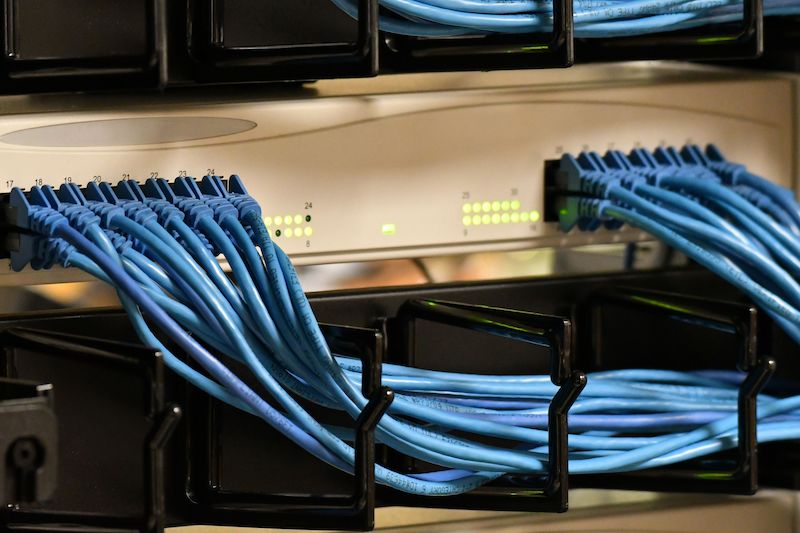

Office networks (Ethernet) are wired according to the “star” topology, with cables terminating at a central switch, like spokes on a bike wheel. In industrial networks, topologies like the “bus,” “daisy chain,” “chicken foot,” or “ring” are common. Each topology has rules that must be followed during installation to ensure proper electrical functioning of the network.
Figure 2. Ethernet cables connected to a sever.
Networks may also have their own requirements for the cable and connectors. It is more complicated than the standard CAT-5E or CAT-6A used in office networks. For example, Profibus/DP requires a different cable than DeviceNet and AS-Interface. Even industrial Ethernet protocols have their own cables: ProfiNet uses a 4-wire cable, with different color coding for the individual wires. An Ethernet expert would not recognize ProfiNet as Ethernet by just looking at the cable and the connector. Additionally, some industrial Ethernet protocols allow for daisy-chaining the network cables, not seen in standard Ethernet since the 1990s.
To avoid corrupted data due to external electromagnetic interference, cables need to be shielded. Usually, this is called STP (shielded twisted pair), in contrast to UTP (unshielded twisted pair), common in office- and home-networks.

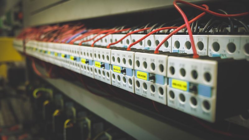

Programmable logic controllers (PLCs) run applications cyclically. They read all (analog and digital) inputs, process them, and write all outputs. This PLC cycle is repeated every few milliseconds. The industrial network must read/write the inputs and outputs at the same pace (and preferable faster); this is the network cycle-time.
Figure 3. A PLC cables system.
This network cycle-time depends on the number of devices on the network, the amount of data per device, the overhead in network messages, and the speed (bitrate) of the network. Typical for industrial network protocols is that messages usually only contain a few bytes of (I/O) data, and thus the protocols are optimized for this. Office networks, like Ethernet, are optimized for the transfer of large amounts of data.
Ethernet functions are suboptimal when used for transferring network messages with a few bytes of data. For example, a network message with 1 byte I/O data had 83 bytes overhead added. So a raw speed of 1 Gbit/s only brings the application an effective speed of 11.9 Mbit/s. That is why the bitrate of a network doesn’t say much about the effective speed; the application characteristics and software overhead must also be known. This is how many industrial network protocols execute fully in hardware; no software (with associated delays) is needed. Beckhoff’s EtherCAT is an example of a fast industrial network with the support of network cycle rates up to 80kHz.

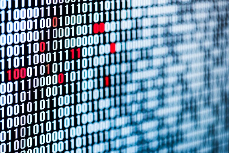

One area where office networks and industrial networks function identically is in the detection of corrupted data. Due to electric disturbances, bad cabling, or aged electronics, a bit transmitted as a 0 received as a 1 (or vice-versa) can occasionally happen. Working with corrupted data is dangerous, which is why every network protocol detects corrupted data. This data is immediately discarded.
Figure 4. The red bits indicate data corruption.
Although the detection of corrupted data is not 100%, the likelihood that a corrupted bit slips through all checks is very small. If the cabling of the network is of good quality and installed according to the requirements, earthing and shielding is OK, power cables do not run alongside network cables, etc., the likelihood that a corrupted bit slips through is only once per several million years or more. That is why it is so important to pay good attention to network cabling.
