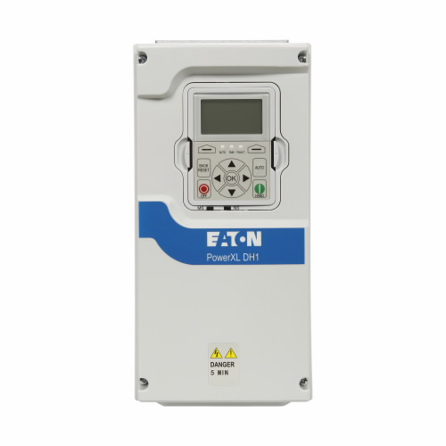

Choosing between a soft starter vs VFD: Eaton VFD
Figure 1. A variable frequency drive. Image used courtesy of Eaton
The main difference between these drives is that a soft start is only for starting and stopping, while VFDs can control speed throughout the operation. Due to the cost associated with VFDs, soft starters will be the best solution if a motor operates at a continuous speed.

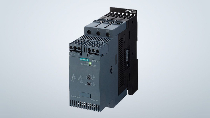

Soft start vs VFD: Siemens SIRIUS soft start
Figure 2. A soft starter. Image used courtesy of Siemens
After finding this cost, compare it to the estimated energy savings, factoring in a 3% loss for the VFD. Once calculated, it should be apparent if the ROI is less or greater than the cost between a soft start and VFD. How do you find the difference in cost between a soft starter or VFD?

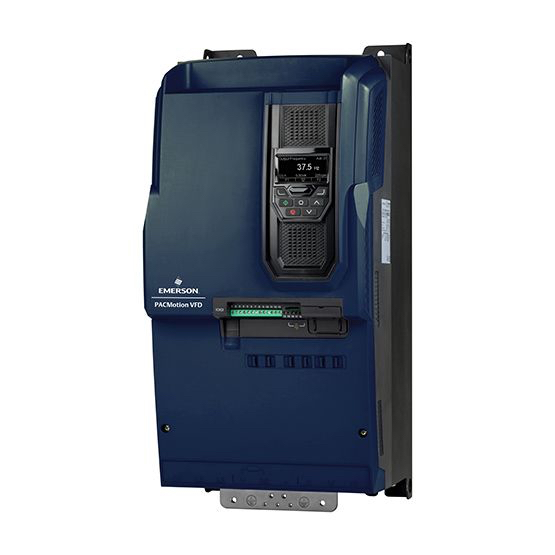

VFD vs soft starter: Emerson VFD
Figure 3. A variable frequency drive. Image used courtesy of Emerson
