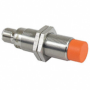

Wet contacts are most likely to be seen in solid-state switching, such as sensors. Once power is provided, the simple switching action sends this same supply power off to the load device. No extra common power wires are required.
Figure 2. This proximity sensor utilizes wet contacts. Image courtesy of Grainger.

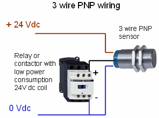

Probably the easiest place to start with identifying which type of contact is used is to count the wires going to the device. If there are only three wires, it must be a wet contact. The internal circuitry must have a supply + and - (or line and neutral for AC), so if there is only one wire remaining, then it must supply that same power to the load.
Figure 3. A PNP sensor has three wires and is a wet contact device. Image courtesy of Schneider Electric.

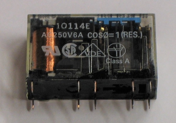

Four wires would be counted on most control relays. Two of the wires must be used to power the device, just in a sensor. But in this case, the remaining two wires are for the + and - of the load circuit, completely isolated and often at a different voltage.

Figure 4. This relay shows an example of isolated dry contacts: the copper coil terminals are on the left and all the contact terminals are on the right.
