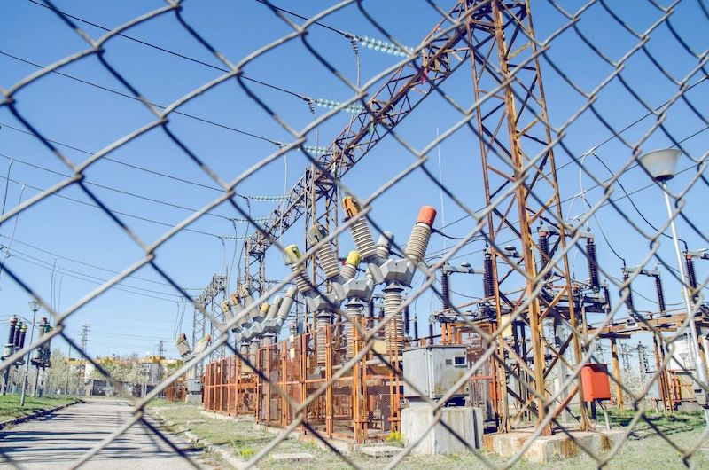

On the other hand, the origins and history behind each device are different. For their part, RTUs have closely trailed along with the evolution of SCADA systems, of which they are essential components.
SCADAs and RTUs were first introduced in the telecommunications industry, then later in power generation plants in the 1950s. The problem they were trying to solve was the communication of data from field instruments over very long distances.
Figure 1. Power distribution networks rely on RTUs and SCADA systems to monitor important variables over long distances.

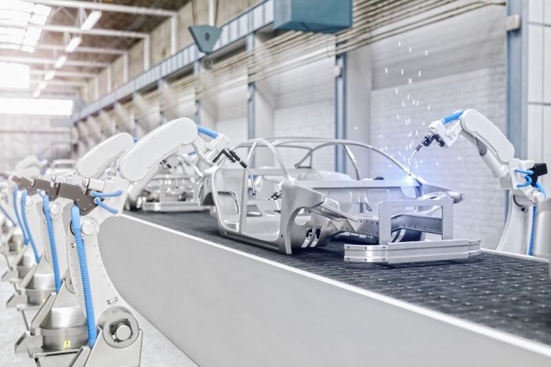

PLCs came into the scene later, in the early 1970s. PLCs only became possible once compact personal computing and microprocessors reached a certain stage, where it was viable to mass-produce. PLCs went straight into the industrial manufacturing world, replacing complex, inflexible circuitry consisting of numerous relays with a compact device that could more easily fit on the production floors. The automobile manufacturing sector was among the first to benefit from the introduction of PLCs.
Figure 2. Automotive manufacturing and process automation rely heavily on Programmable logic Controllers (PLCs).

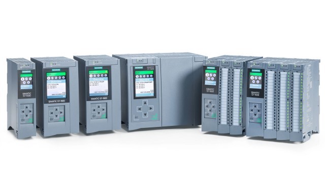

PLCs are essentially computers designed for the automation of industrial processes. A PLC consists of a central processing unit (CPU) and inputs and outputs. The CPU is responsible for executing the user-installed program. Several types of modules can typically be integrated with a PLC: digital and analog inputs and outputs, network communications, protocol adapters, bus extensions, among others.
Different programming languages can be used to code instructions for PLCs, the most popular being ladder diagram and structured text. A ladder diagram, sometimes called ladder logic, is a visual programming language that emulates opening and closing contacts and relays. Structured text uses a syntax similar to C-based languages. It allows for more complex instructions than ladder; thus, it is generally used in more complex control applications.
plc
Figure 3. A Siemens PLC, the SIMATIC S7-1500, one of the most widely used modern PLCs. Image used courtesy of Siemens
Every PLC works by cyclically executing three basic tasks in sequence: read inputs, execute the program, and write outputs.
At the start of each cycle, the PLC needs to update the status of all the physical inputs connected to it, so the correct state is used. Then, the pre-loaded program is executed, running through main routines and subroutines. Finally, the physical outputs are updated based on the results of the program execution. This is done each PLC cycle, and cycle time is one key metric programmers are frequently trying to optimize for increased system performance.

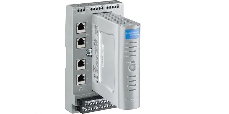

RTUs are microprocessor-based control units designed to monitor and control field devices. They are used primarily in SCADA systems, proving the interface between the SCADA control and the physical processes and their sensors and instrumentation. Similar to PLCs, RTUs also consist of CPU and inputs and outputs modules, as well as communication and protocol translation options.
Remote Terminal Unit RTU
Figure 4. A ControlEdge RTU with HART-enabled I/O communication abilities. Image used courtesy of Honeywell
Programming RTUs is generally much simpler than programming PLCs. Most RTUs are configured via a web interface, and not much more than that configuration is performed. Although modern RTUs are compatible, most are not intended or do not support control loops and complex logic. Cycle times are extremely fast, typically in the 1-millisecond range.
