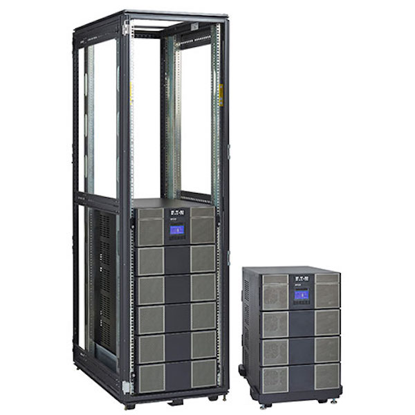

Double Conversion
Double conversion systems, also known as "online" UPSs, convert power twice. In the first step, the input AC power is converted to DC and fed to an inverter. Then, the DC power is converted back to AC and sent to the output to feed connected equipment.
Eaton 9PXM UPS
Figure 2. The Eaton 9PXM UPS system for data centers, retail, and other mission-critical IT applications. Image used courtesy of Eaton
Like single conversion systems, as soon as the input power falls out of the determined window of tolerance, the UPS switches to battery power and feeds the output inverter. This type of UPS achieves a high level of connected component isolation from outside utility power and is typically recommended for critical IT infrastructure, such as server rooms.

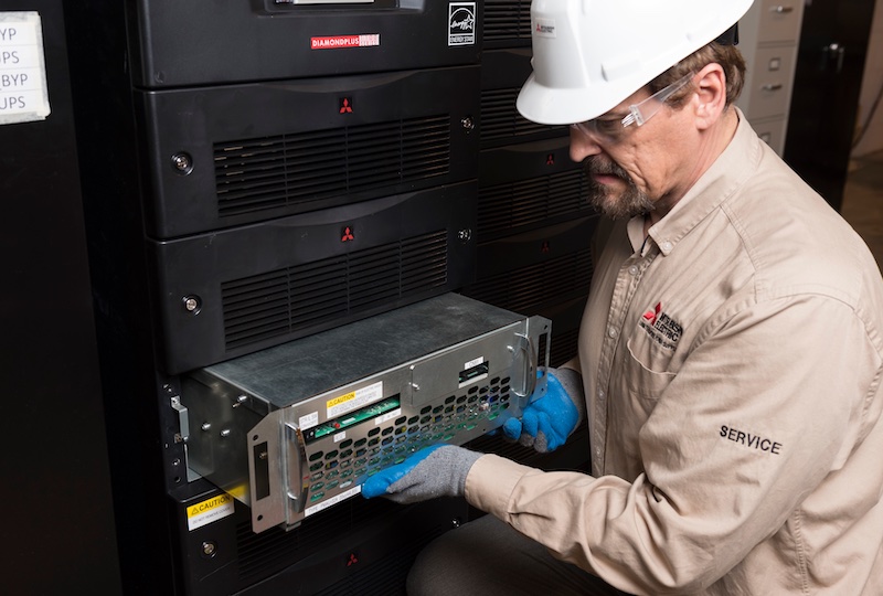

Data Centers and Server Rooms
Data centers and server rooms, which play a vital role within many modern automated system infrastructures, are where integrating UPS units is most common and well-studied. These areas use either multi-mode or double conversion—the goal is to keep critical servers running throughout a power outage.
Depending on the power loss duration and UPS size, the backup power might not be enough to keep the system live. In this case, the UPS provides at least enough time for a soft system shutdown, which helps avoid data loss and prepares for a smooth restart.
Mitsubishi Electric DiamondPlus 1100 UPS
Figure 3. A DiamondPlus 1100 hot-swappable UPS from Mitsubishi Electric. Image used courtesy of Mitsubishi Electric
One key characteristic of UPSs in these applications is switching time. Due to some data transactions happening within milliseconds, switching time needs to be smaller or imperceptible to avoid disrupting the process. This is a feature that many UPS manufacturers are focusing on improving.
