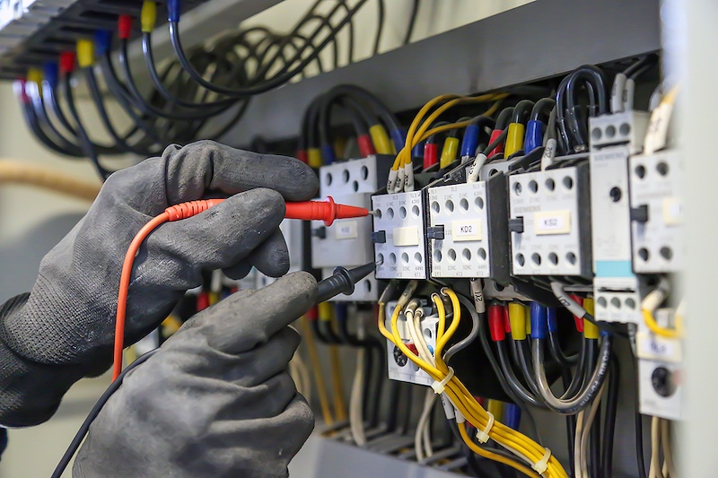

An industrial technician wiring in an AC system.

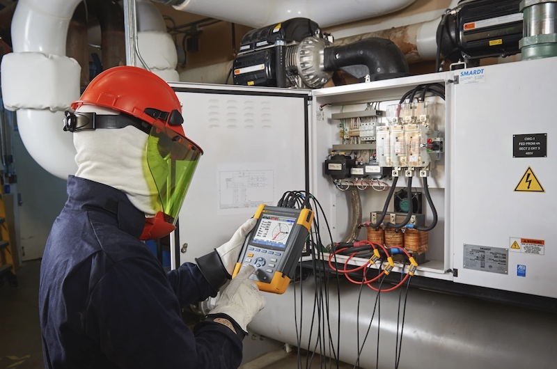

An engineer measuring both single and three phase power. Image used courtesy of Fluke
At any given moment, if you add up the current in all three phase wires, the total sum of the current to or from the load is 0 amps. This does not mean that there is no current. It simply means that there is no extra current going to or from the load between the shared current load of all three lines. Even if a neutral wire were provided to the load, it would never be used.

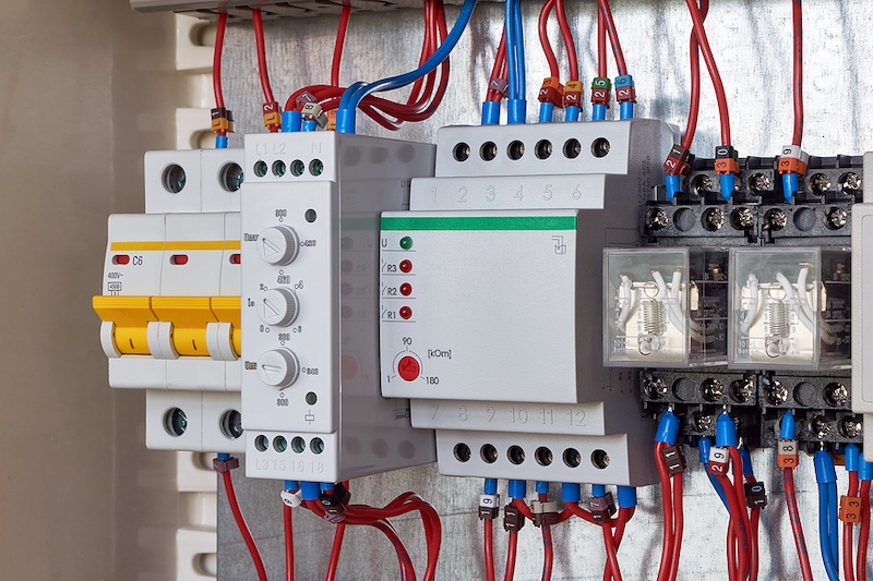

A Modular three-phase circuit breaker, phase control relay with adjustments, level control relay, two intermediate relays in a control cabinet.
