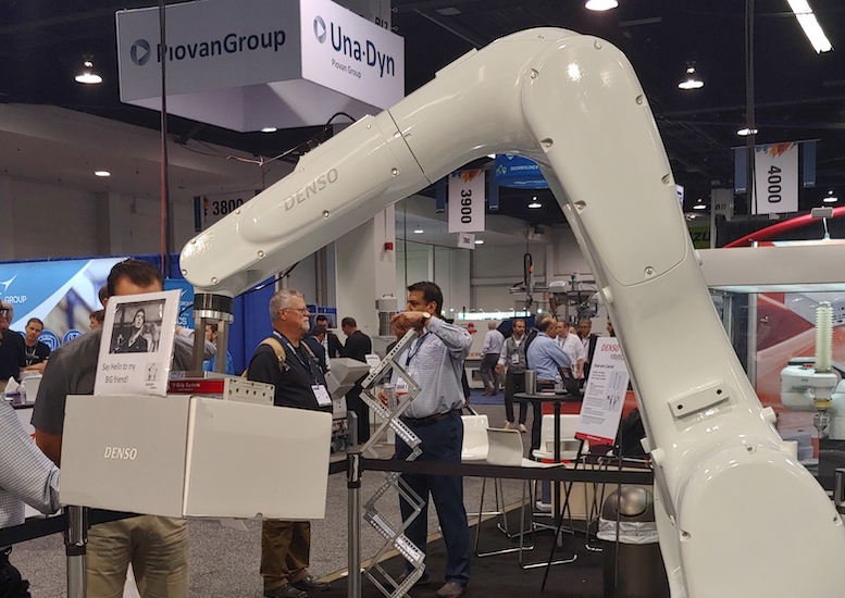

Robot from Denso
A large robot from DENSO. Image used courtesy of Denso.
