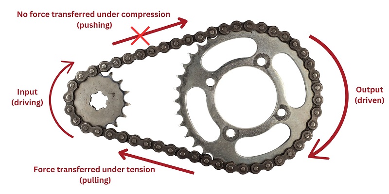

Physics of interaction for chains and sprockets
Figure 1. The interaction of the driving (left) and driven (right) sprockets shows the force applied only to the pulling side of the chain. Image used courtesy of Control Automation
As the input sprocket begins to rotate, any drooping slack in the chain is pulled tight, but only on the side from which the driving sprocket is pulling. You cannot push a chain. The force that pulls on the chain from the driving gear comes from the torque provided by the driving source, like a motor or steam engine. If the motor produces 100 ft-lb of torque on a sprocket with a 1 ft radius, the pulling force applied to the chain is 100 lb.
This same 100 lb force pulls along the outside radius of the driven sprocket. Assume this driven sprocket has a 2 ft radius. This would result in 200 ft-lb of torque on the driven shaft. The offset of this increase in torque is a 50% decrease in rotational speed, as two full rotations of the input shaft are required for one full output rotation.

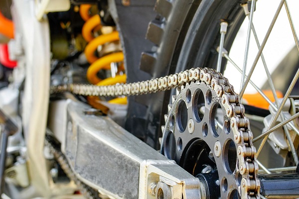

Slight droop in a chain
Figure 3. This chain drive for a motorcycle shows a slight droop. If the vehicle is reversed, the slack must be removed before the wheel starts to rotate. Image used courtesy of Canva
