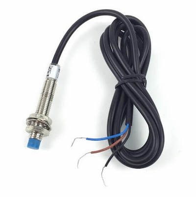

Figure 1. Example of an NPN sensor. Image courtesy of Cytron.

The simplest way of describing the operation of an NPN sensor is to break it down into two parts. First, supply power for the sensor. Most often, this is a range of 10-30 volts, so it’s compatible with 12-volt and 24-volt systems. Connect the appropriate wires (usually brown and blue in some order) to the power supply.
The remaining wire is the signal wire (sometimes called ‘load’ wire). For this NPN sensor, current will flow from the input module through this signal wire as soon as the sensor is energized. The only condition for this to work is that the signal grounds MUST be connected between the input module and the sensor itself in order to complete the circuit.
