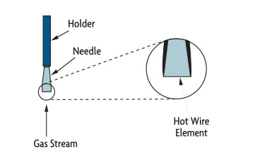

How Does an Airflow Sensor Work?
There is more than one working principle for an airflow sensor and these principles depend on the sensor’s type and application. Airflow sensors commonly use the principle of thermal anemometers (also known as hot wire anemometers).
Figure 1. The hot wire element’s temperature is controlled by a sensor. Image courtesy of Omega
In a hot wire anemometer, there is a heating element that uses electrical energy to heat. When airflow touches the heating element, it cools down. These anemometers also contain a temperature sensor that measures the heating element’s present temperature. As the heating element cools down, the sensor measure this difference and again heats up to its set value.
The amount of electrical power required to maintain the heating element’s temperature (as a result of cool down by the airflow) represents the airflow rate. The output is a proportional voltage in response to the airflow rate. The measured data is then available in the form of voltage or current depending upon the type of sensor and user requirements.

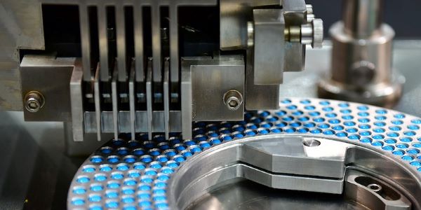

Industrial Example: Tablet Coating Pan
Let’s look at an example of airflow sensors used in pharmaceutical manufacturing. Tablet coating pans are necessary and critical equipment in the pharmaceutical industry. Their function is to coat a tablet with the necessary material. A thin layer of material is deposited on the tablet surface using the spray method.
After the spraying process, the tablet drying process takes place. In this process, hot air passes through the bed of tablets. This hot air removes the solvent into which material dissolves and, as a result, the material is left behind on the tablet’s surface.
Figure 2. Airflow sensors are used in multiple areas of pharmaceutical manufacturing.

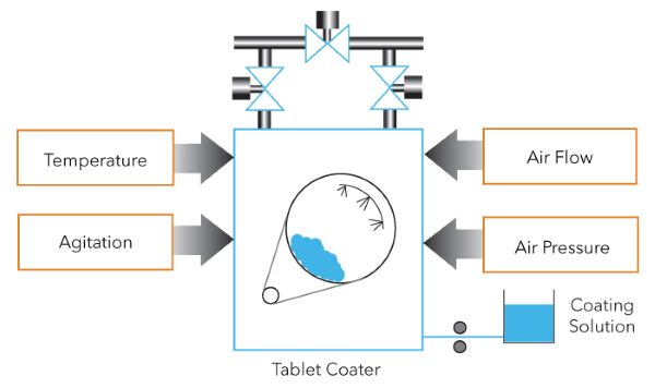

Airflow Rate in Tablet Coating
Airflow sensors measure the amount of hot air that passes through the tablet bed. It is demanding and essential information as excessive flow rate damages the tablets, and a low flow rate creates a subpar product.
Figure 3. Diagram of the tablet coating process.Image courtesy of Eurotherm.
The product development team selects the airflow depending on the characteristics of the product. The particular value of the airflow remains fixed in the recipe for every product. Blowers that run through variable frequency drives (VFD) maintain the flow rate.
The values from the airflow sensors are continuously monitored with the help of the main controller or PLC. Airflow sensors immediately sense any changes in the airflow. As per the algorithm, the PLC or main controller increases or decreases the blower (operated through VFD) speed until the airflow sensors sense the correct airflow.
