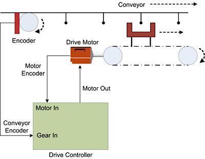

Figure 1. Schematic of electronic gearing using a drive motor.

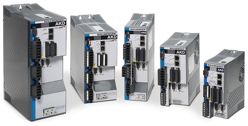

In the simplest terms, a servo drive is essentially a computer with specialized software for servo motor control. The desired output motion is programmed here.
The motor’s feedback device, which tracks its shaft position as it turns, transmits this signal to the drive for computing. The drive uses this feedback data to calculate the values used in a PID loop, such as current position and error (error being the difference between where the program wants the position to be and where the position actually is).
Figure 2. Examples of high-performance servo drives. Image used courtesy of Kollmorgen
In addition to calculating how to move the motor, a drive also needs to move the motor. To do this, the drive (which supplies power to the motor) will vary output current to the motor to induce it to rotate at a particular speed and direction.

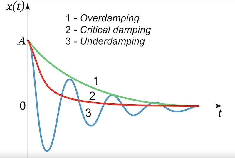

Once a servo system is installed, an engineer will need to tune the system before the intended process can run independently. Servo tuning refers to how well the output motion of the motor is responding to its commanded position. Is it quickly jerking toward its destination and overshooting the position, having to then backtrack to get into the correct position? Is it not overshooting its position but being so cautious about moving forward that it takes longer than desired to reach the target position? These would be examples of “underdamped” and “overdamped” tuning parameters, respectively.
Ideally, the desired position should be reached as quickly as possible with minimal overshoot. These might be “critically damped” tuning parameters with a minimized “settling time,” as depicted by the red line in Figure 3.
Figure 3. Illustration showing position error over time given different tuning parameters. Image used courtesy of Math24
Primarily, the tuning parameters in question are constants KP, KI, and KD. They affect the proportional, integral, and derivative portions of a PID loop, respectively. Tuning (choosing values for) these parameters manually is notoriously tricky.

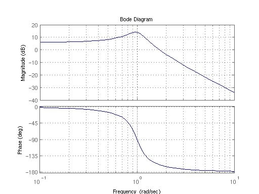

A feature that can help with the tuning process is a virtual oscilloscope. This can allow an engineer to graph commanded motion, actual motion, and I/O response at a high time resolution to see how the system responds. This is a useful tool when manually tuning. A drive may even produce Bode plots, which can be useful for a system’s general maintenance.
Figure 4. Bode plot for a control system. Image used courtesy of Netnet

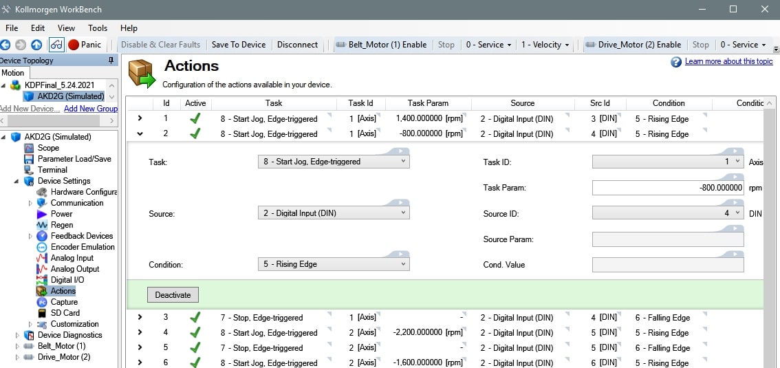

Drives vary in the method of programming offered. Some are programmed in one or more of the five standard IEC languages: ladder diagram (LD), function block diagram (FBD), sequential function chart (SFC), instruction list (IL), and structured text (ST). Other languages, such as basic, may be used. Proprietary programming languages are common, as seen in Figure 5, some of which are designed for ease of use for those with limited programming skills.
Figure 5. A screenshot of a motion control program in a Kollmorgen AKD2G drive using an action table where moves are programmed by selecting options within a dropdown list.

More advanced features may include the capability of driving multiple motors simultaneously, gearing or camming a secondary server motor to a client, input for an external emulated encoder to base your motion off the position of a secondary object, and safety features, including safe torque off (STO) and safe motion profiles.
