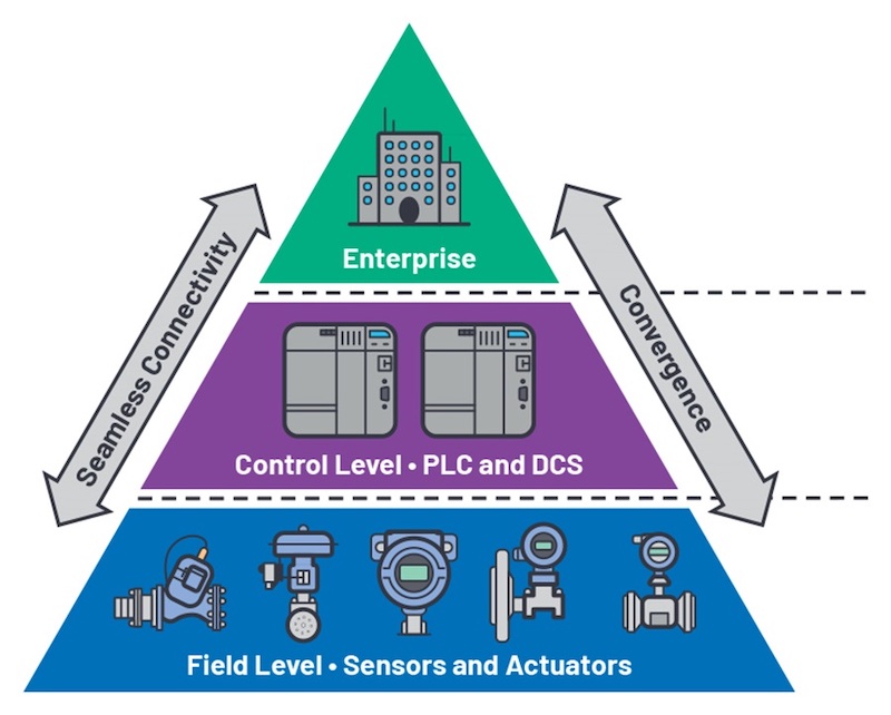

three-layer factory network model pyramid
Figure 1. The three-layer factory network model pyramid. Image used courtesy of Analog Devices
The three levels of a factory network are:
  • Device level
  • Control level
  • Enterprise level
This model can be seen as a pyramid. The device level is at the bottom of the pyramid, containing field devices, sensors, actuators, and all other floor-level components. The control level is next; this level includes robots, PLCs, HMIs, and SCADA. Last, at the top of the pyramid sits the enterprise level, comprised of the higher-level software applications that plan and strategize tasks for the components of the other two layers. More details about the components and functions of each level will be discussed in the next sections.

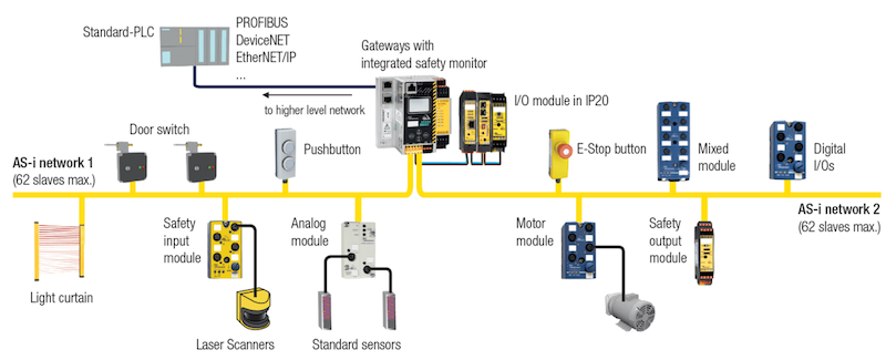

Sensor Bus
These are the least complex networks, where data is mostly transferred in bits. In these networks, a single network cable can connect multiple field devices, such as limit switches and optical sensors. The sensor bus network can also transmit output signals through the same cable to indicator lamps, alarms, or other actuator devices. Some well-known bus networks are ASi and Seriplex.
Figure 2. The ASi network is an example of a device-level network. Image used courtesy of Bihl+Wiedemann

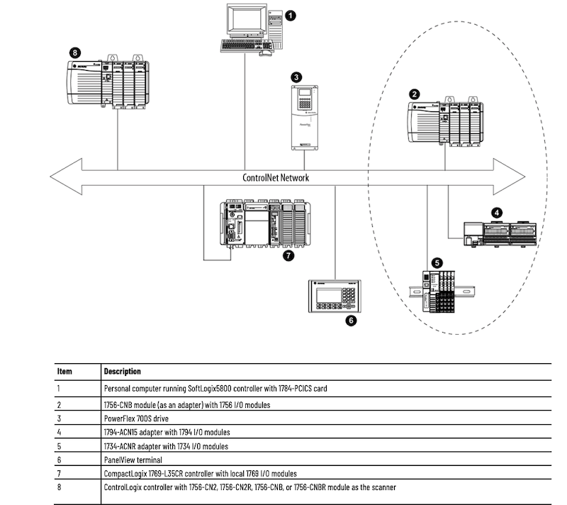

Control level networks are the realm of programmable logic controllers (PLCs), human-machine interfaces (HMIs), supervisory control and data acquisition systems (SCADA) user interfaces, and other advanced devices, such as vision systems, industrial robots, and motion controllers. These networks are the most advanced networks on the factory floor, where data communication happens at a fast speed.
The main types of information flowing at this level are source code, programs, parameters, and data from advanced devices. Typically, PLCs connected to device-level elements are also connected to each other, as well as to HMIs. The HMIs enable the configuration, control, and manual operations of the instruments in the network.
ControlNet network diagram
Figure 3. Diagram of a ControlNet control network. Image used courtesy of Rockwell Automation [PDF]

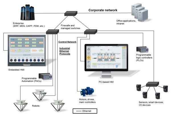

Enterprise Level
The enterprise level is also referred to as the information level. At the top of the pyramid, it is the most overarching network level that manages the automation system strategically, as well as connects computers and departments of a company together. In addition to managing the automation and production process, the enterprise network interconnects production planning, quality management, market analysis, supply chain, orders, shipments, and other processes of a company.
Figure 4. Enterprise level and control level networks are directly connected. Image used courtesy of Automation Direct
Many systems incorporate software platforms at this level, such as enterprise resource planning (ERP), which helps further integrate and automate the processes. In highly automated systems, there are other software applications that are above the control level and communicate directly with ERPs. For example, warehouse management systems (WMS) and management execution system (MES) applications are responsible for the strategic and efficient automation of production and logistics tasks.
Information exchange happens on a large scale, and it is mainly computer-driven, allowing for the collection and monitoring of data, as well as other tasks such as file transfers and email exchange.
