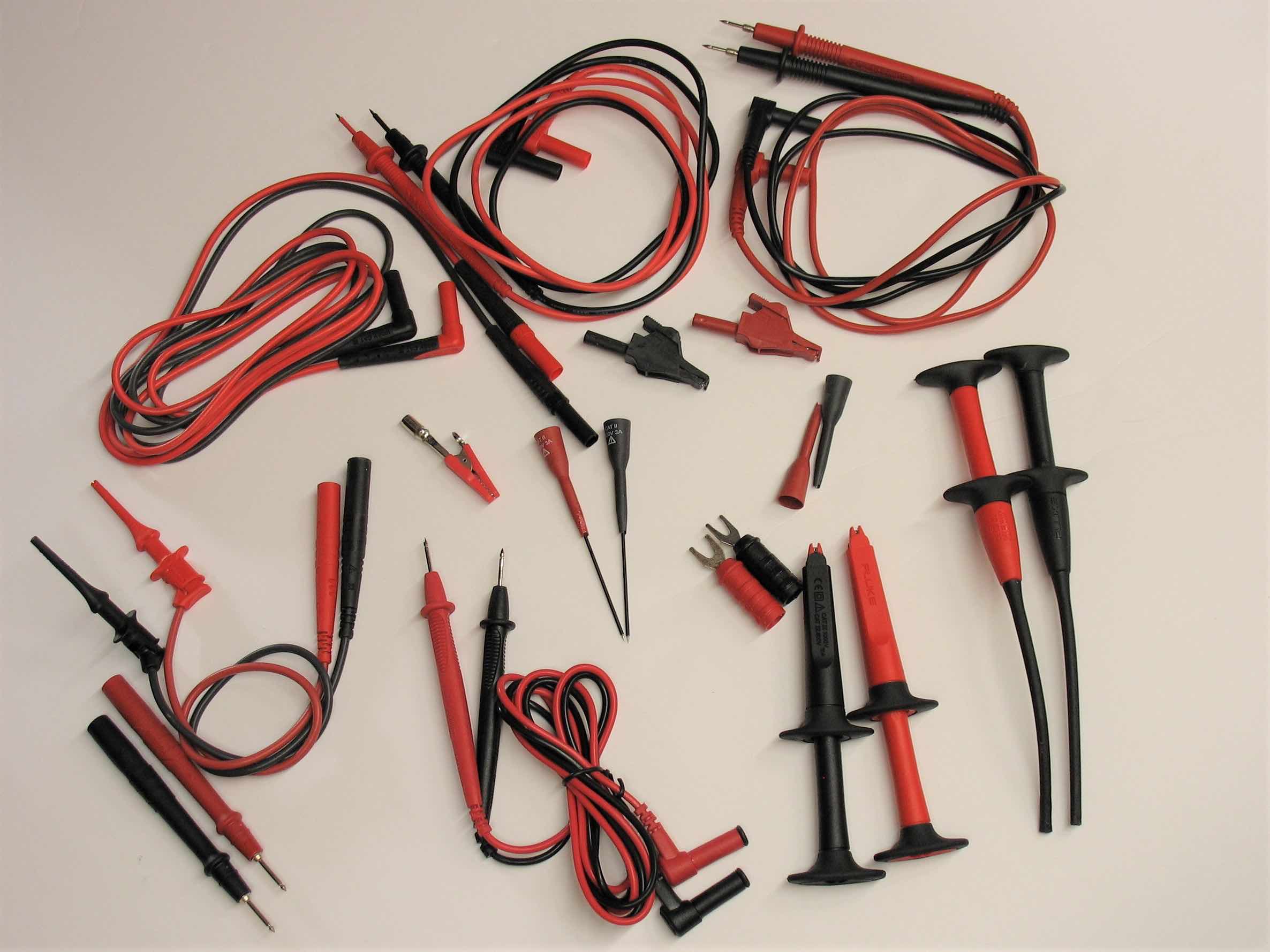

When it comes to test leads, there is a surprising variety. Most meters will include the standard default set with a single set of red and black cable, each with a thin silver tip. It works sufficiently for most tasks, hence being the default choice, but it won’t work in all situations. As always, I cannot provide an overview of every test lead in existence, since I’m certainly not familiar with all cases and situations, but this article will share many of the common choices.

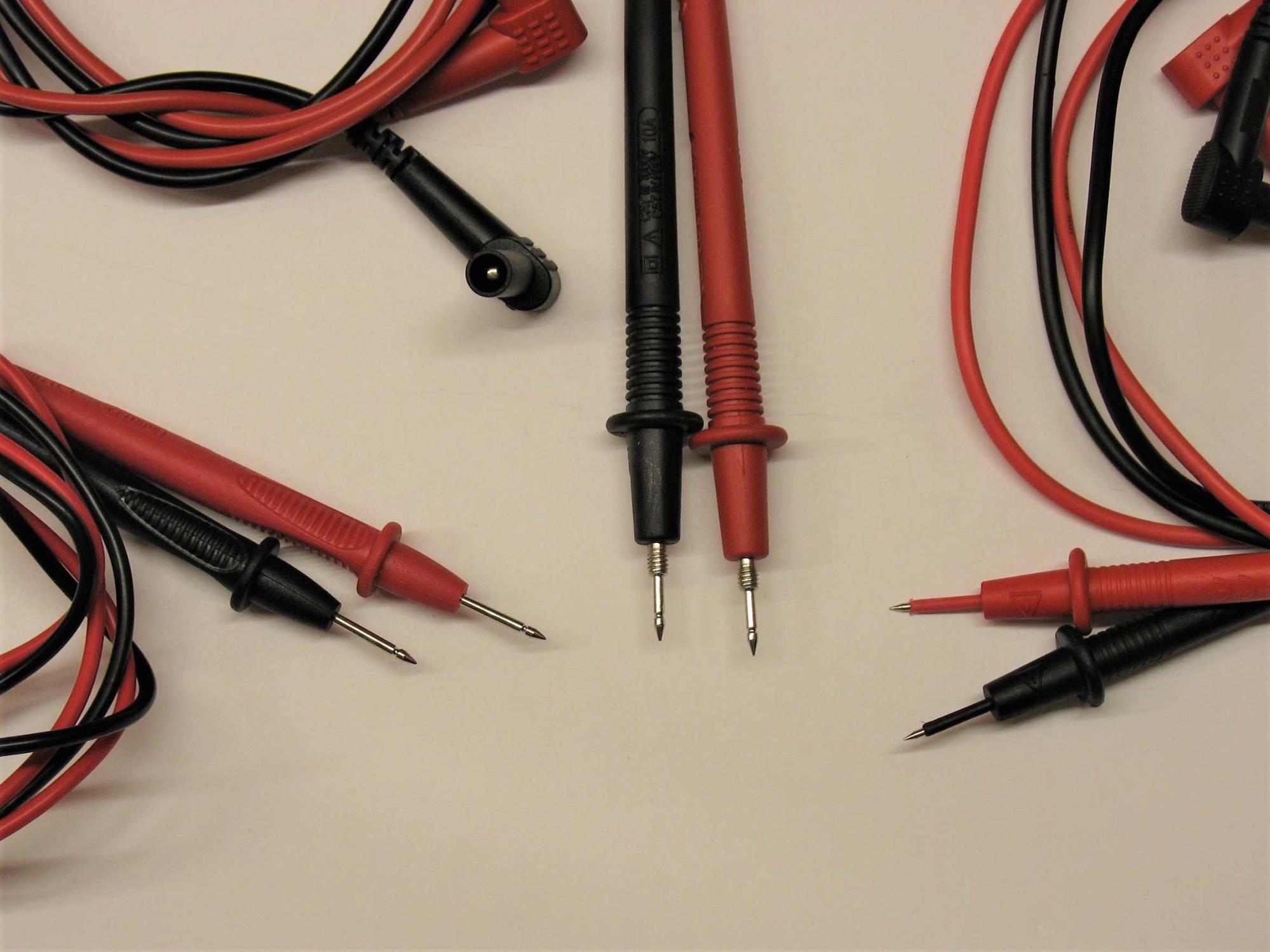

Basic multimeter leads must always include a set of 2x cables, and most of the time one is red the other is black. They usually have about ¾ inch of exposed metal at the end, terminating with a pointed tip. About 1/4 inch away from the end is a small shoulder, used for anchoring the test lead inside some devices such as industrial terminal blocks, or attaching some extra cable which grabs the metal, giving it a point to connect without sliding off the end.
A few variations of this basic cable style exist, and one that I have found useful includes a very short threaded shoulder just as the metal tip begins. Many end attachments such as alligator clips and grabbers may use this thread to provide a great secure attachment. Although not always vital, it does provide some security in making measurements.
A close-up of several ‘standard’ meter leads. They include the default standard, the one with a small threaded section, and the insulated fine-point tips from left to right.

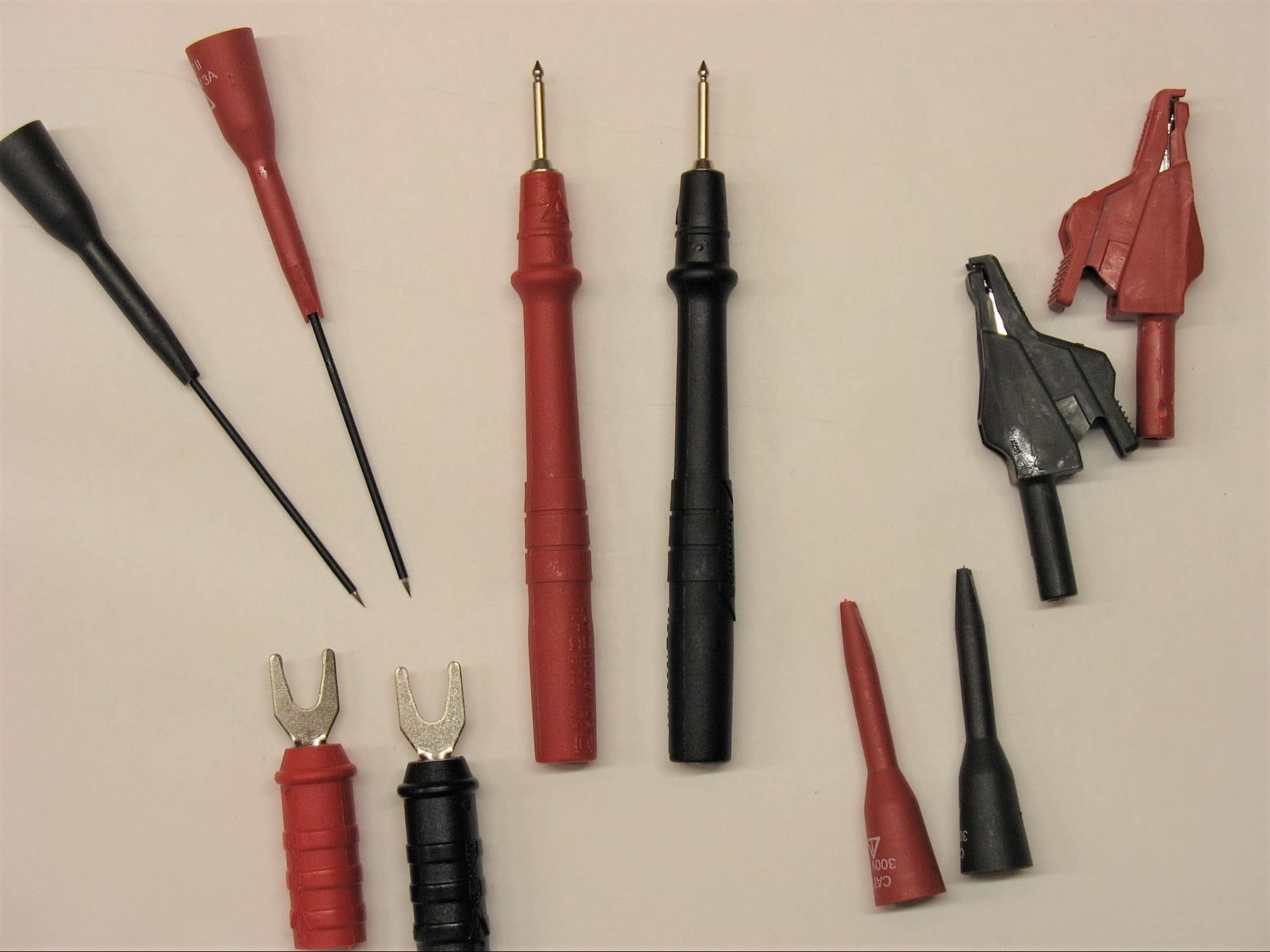

Another common option is close to the normal lead, but only a very fine point is exposed at the very end. When making measurements of very small points that are located close to each other, touching the two leads can cause a short circuit and instant irreparable failure. The tightly insulated leads help keep the circuit safer for those tiny measurements.

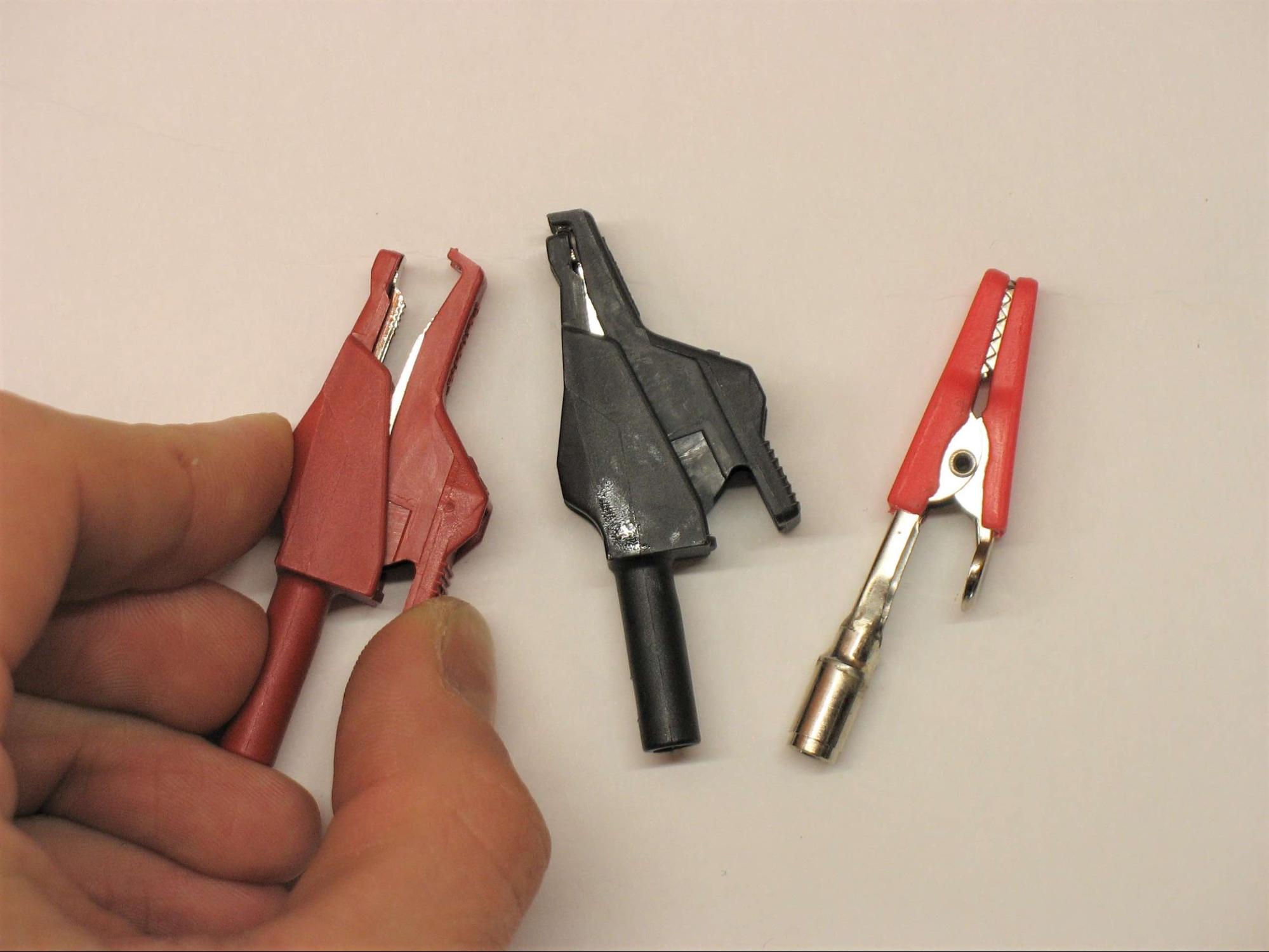

They resemble the mouth of an alligator. These clips are designed to securely connect to test points on circuit boards or exposed wire ends. With one lead securely clamped, it leaves one hand free to ensure that safety can be taken and the instruments and controls may be adjusted as necessary.
Most of the time, they will consist of small end attachments that simply slide or thread onto the end of a normal test lead.
Other times, it may be an external cable that clamps to both the test lead and to the circuit board, although I’m not a fan of this option. Too many times the cable has come off the end of the test lead. Harmless in all of my cases, but if the situation was expensive or potentially hazardous, I’m not going to take the risk.
A few alligator clip ends. Note that the exposed metal one usually has an insulated jacket over the top, but it’s been removed to show what it looks like inside.
A final option is sometimes the alligator clips are permanently located at the end of the test lead cables. In other words, it’s devoted to being alligator clips only. If you find that you need the clips a majority of the time, maybe the cables are a good investment.

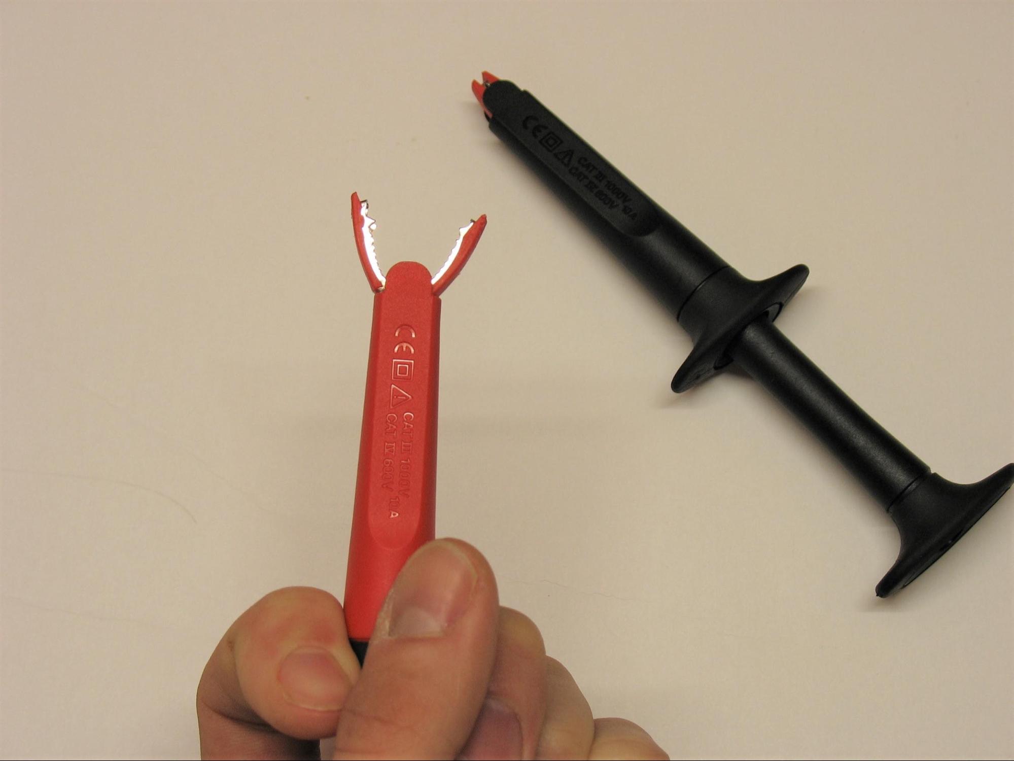

These attachments are similar to the alligator clips, but the end is a small, spring-loaded hook. This is my preference for measuring values on a circuit board where the only access point is the wire end of a through-hole resistor or diode, barely exposed on the board.
They are limited to very small diameter wires, so they are ideal in situations that are too close-quarters, or too small for the alligator clips.
Mini grabbers, one integrated into the leads and the other is an attachment for the end of an extension cable.
Like the alligators, they can be found as external cables or as dedicated test leads. I even came across a set of end adapters with the grabbers at the end of a flexible 6 inch long tool for the end of an extension lead.

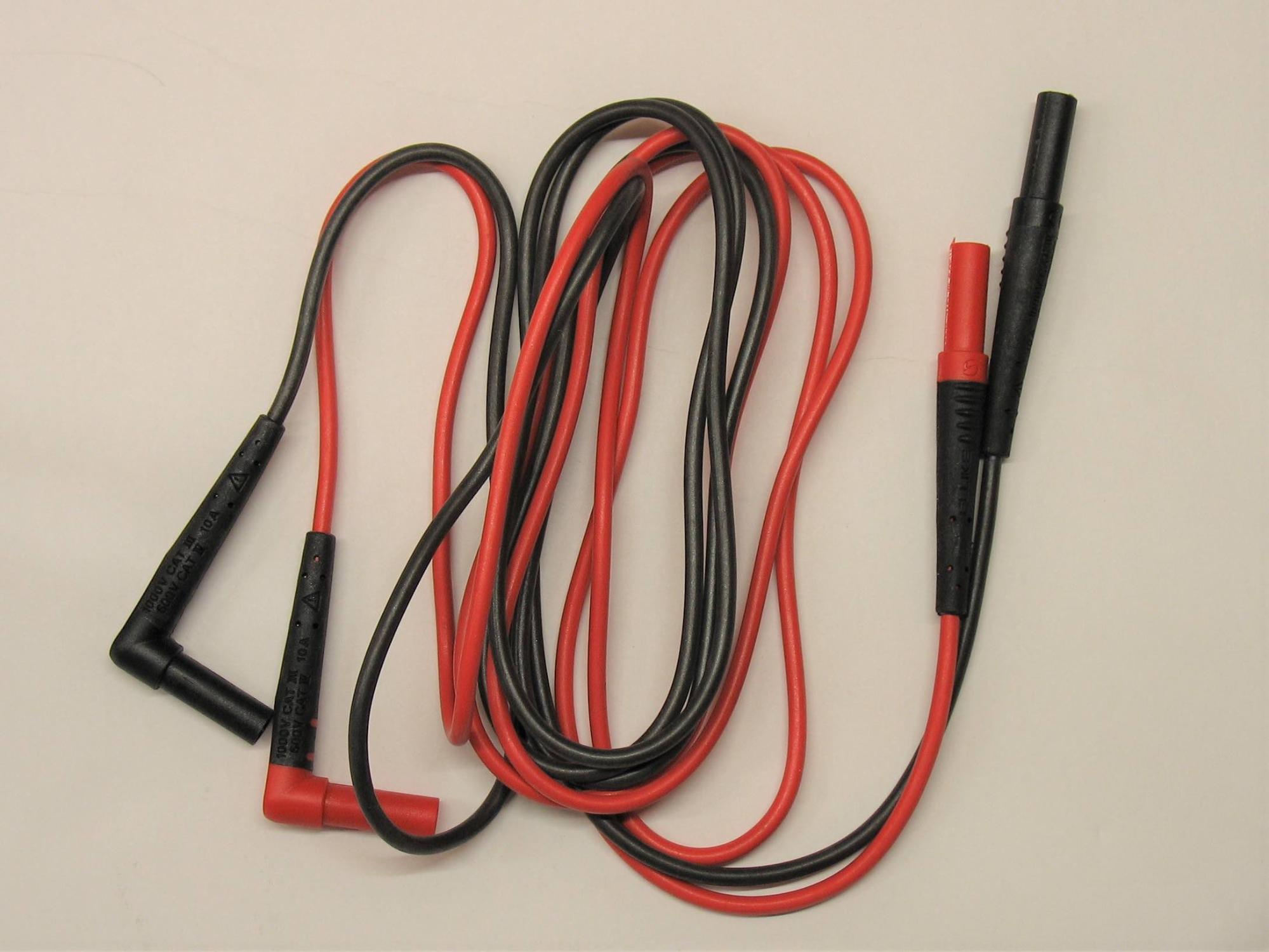

The extension cables open up all kinds of other possibilities. Both ends of these cables could fit into the meter base plug. So the other end is free to connect any of a variety of attachments. You could even mix and match depending on what the specific case called for.
An extension cable with similar connectors on both ends. Either end can connect to the meter, or to the attachments.
I have seen times where someone used normal ‘banana’ cables as an extension to a meter, but I would just add a cautionary note that these cables are not insulated like meter extension leads. The banana style does work, but care must be used, and probably not suited for precision work as the resistance characteristics are not designed for measurements.

The tips for the end can be of all sorts - standard test lead ends, or alligator clips, jaws, fine point tips, grabbers, spade terminals (for an even more permanent attachment), and I’m sure there are many others.
