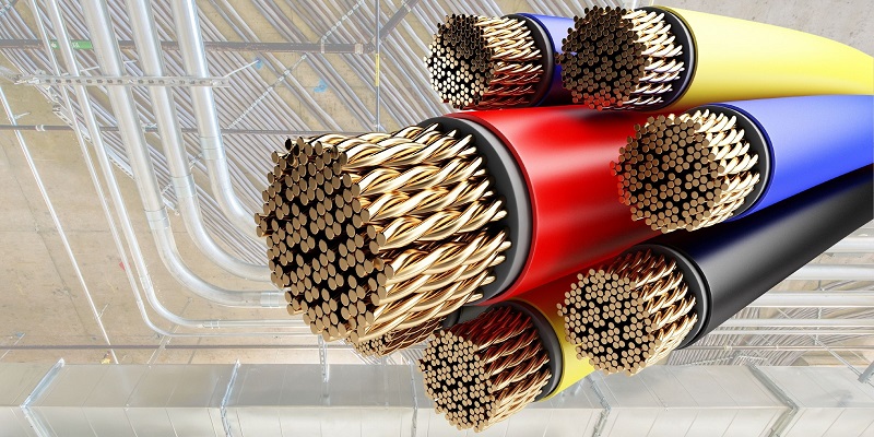

Various wire sizes
Figure 1. Many different wire types exist to minimize the problematic effect of resistance from various sources. Image used courtesy of Canva
