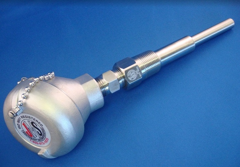

industrial thermocouple assembly
Figure 1. Typical industrial thermocouple assembly. Image used courtesy of JMS Southeast

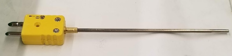

thermocouple with standard thermocouple connector
Figure 2. Thermocouple with standard thermocouple connector. Image used courtesy of JMS Southeast

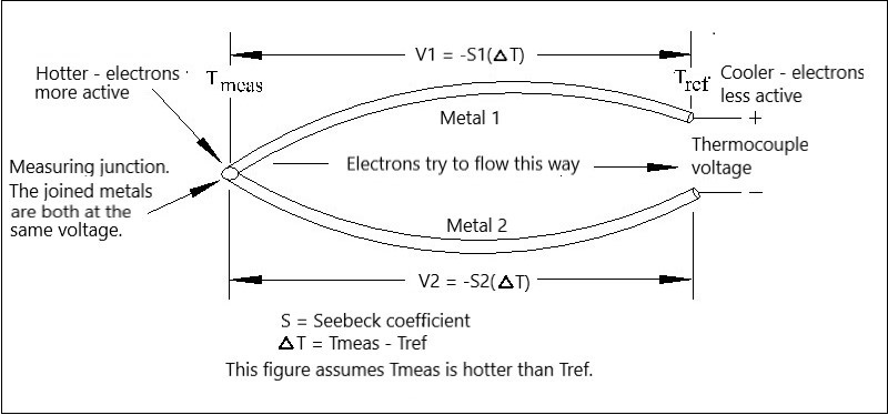

Where Does the Voltage Come from? The Seebeck Effect
The thermocouple voltage is explained by the Seebeck effect, named after German physicist Thomas Seebeck. Here’s an attempt at a much-simplified explanation. See Figure 3.
When a metal is heated, its outer electrons become more active. If one end is hotter than the other, the electron pressure pushes them toward the cold end, making it more negative. Mathematically: ΔV = -S(ΔT).
where S = the Seebeck coefficient, ΔV = the voltage difference and ΔT = the temperature difference.
Different metals have different Seebeck coefficients. In a thermocouple, then, ΔV is different for different metals. The net difference is the thermocouple voltage.
Seebeck effect and Seebeck coefficients
Figure 3. The Seebeck effect generates a thermocouple voltage.
Anything that affects a metal can change its Seebeck coefficient, shifting the thermocouple’s calibration.
