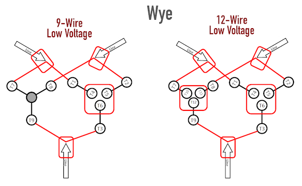

Low Voltage Wye
Two small wye windings are placed in parallel with each other. This diagram compares the two motors, but the gray circle indicates where the bonding is internal in a 9-wire motor.
Figure 2. A comparison of nine- and twelve-wire low voltage wye windings.

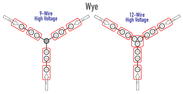

High Voltage Wye
The coils are placed in series from each phase to the internal connection of three coil ends. This connection point is the only difference between the winding diagrams.
Figure 3. A comparison of nine- and twelve-wire high voltage wye windings.

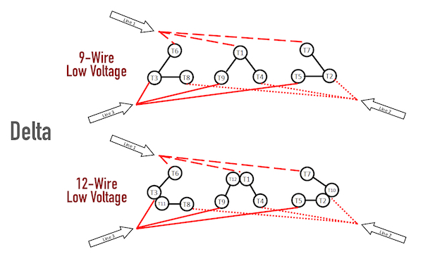

Low Voltage Delta
Two small delta triangles are placed in parallel with each other. The diagrams are similar, but again, there are multiple coils bonded at T1, T2, and T3 in the case of the nine-wire motor.
Figure 4. A comparison of nine- and twelve-wire low voltage delta windings.
