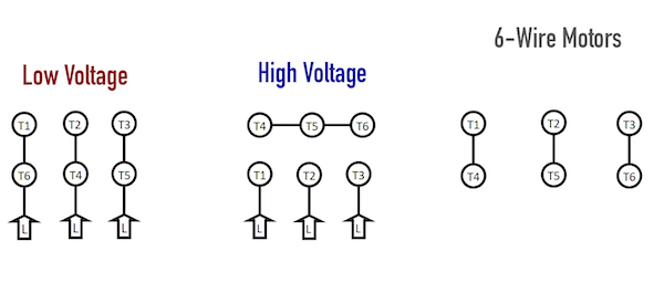

Six-Wire Motors
When the motor has six leads accessible to the electrician, they might be attached to a set of six metal screw terminals inside the motor junction box. It is common to see this set of six screws inside the cover on these kinds of motors. Regardless of whether they appear as terminals or wires, they will be referred to here as ‘leads’.
Internally, the manufacturer has taken each set of two coils on opposite sides of the rotor and bonded them together. This creates three long coils inside the motor. The two ends of each of the three coils are accessible in the junction box, giving six total lead wires.
Figure 3. A six-wire motor uses three individual sets of coils which can be wired for either high- or low-voltage.

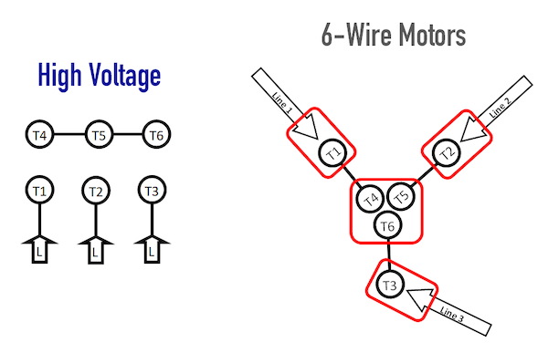

Since there are essentially three coils acting as resistors, they may be connected in series for high voltages in order to decrease the current. This would look exactly like a high-voltage setup in a normal nine-wire Wye motor.

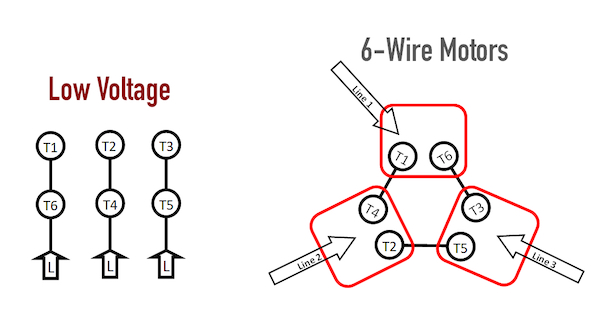

For lower voltage, the three coils are set in a series-parallel Delta configuration, yielding lower resistance to increase the current. Again, this would look exactly like the high-voltage setup in a nine-wire Delta motor.
Figure 4. Low-voltage wiring for a six-wire motor. This configuration looks like a typical 'Delta' arrangement for lower resistance with higher current.
The data plate on a motor like this would often show the low-voltage wiring scheme with a Greek Delta (Δ) symbol, and the high voltage with the common Wye (Y) symbol.
Figure 5. High-voltage wiring for a six-wire motor. This motor looks like a Wye arrangement, leading to higher resistance and lower current.
This is slightly different than the nine-wire motors since in those cases, a Delta motor can be wired for either high- or low-voltage, and similarly, a Wye motor can be either high- or low-voltage. The similarity is that a single motor can be purchased that can be used in either voltage case.
