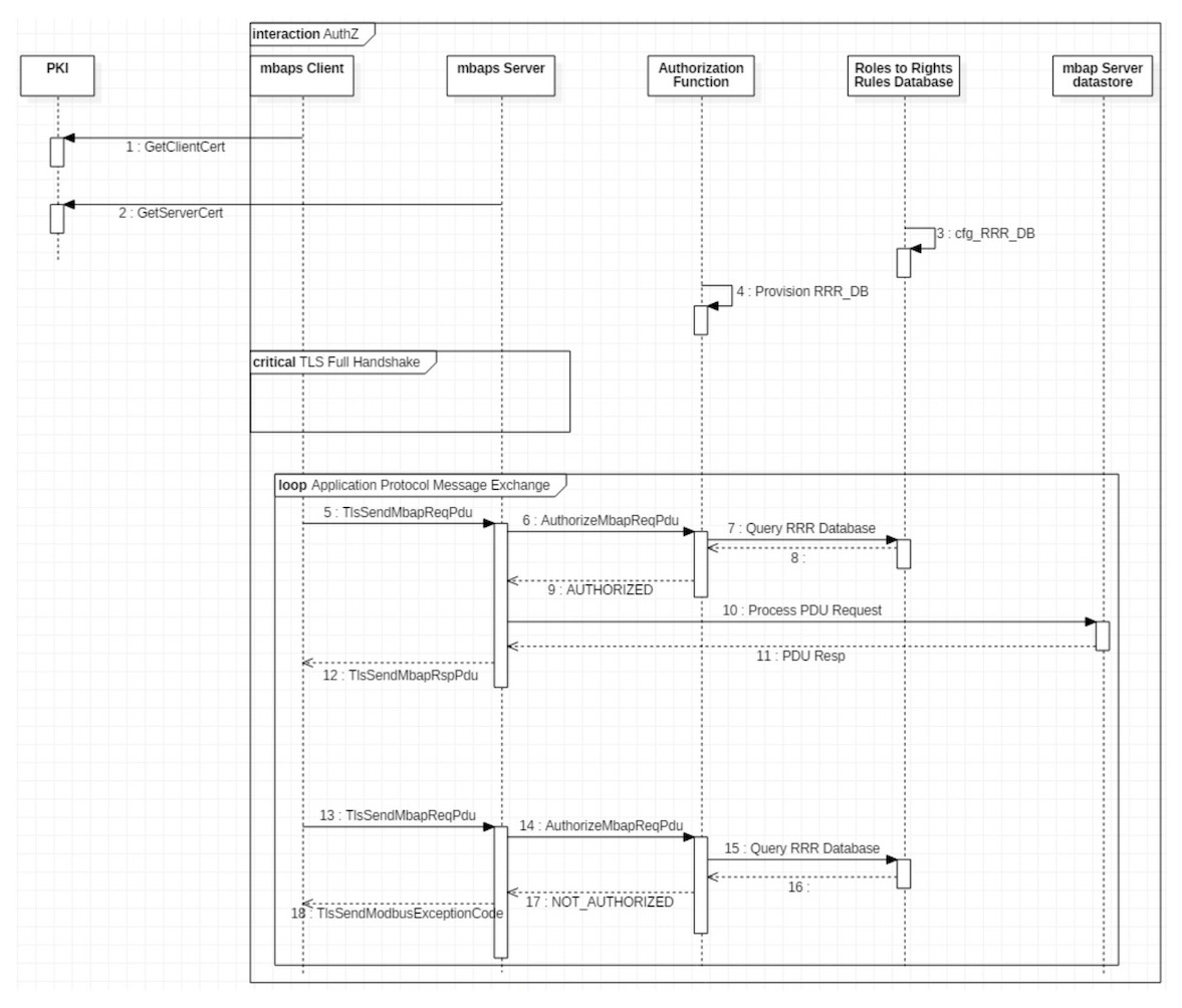

Security comes with added protocol complexity. Many industrial control systems rely upon encapsulating Modbus Application Protocol (MBAP) Protocol Data Unit (PDU) messages carried on a TCP/IP network within a “TLS” layer to secure communications. The combined solution is called ‘Modbus/TCP Security.' This system enables the convergence of industrial operational systems with the nebulous IoT (internet of things) and a whole new class of devices referred to as ‘Industrial Internet of Things’ (IIoT) devices.
What is “TLS” exactly, how does it provide the security needed, and what are the potential weaknesses to consider?
TCP/Modbus security concept view. Image from Modbus
