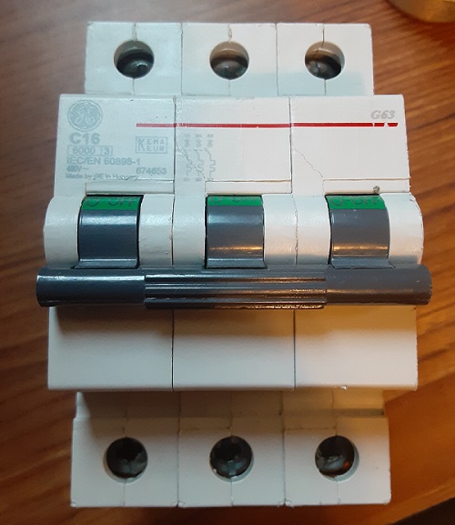

A curve C circuit breaker
Figure 1. A GE circuit breaker labeled with C16, meaning a C-curve breaker with a 16-ampere rating. Image used courtesy of the author
Circuit Breaker Curves
The curve of a circuit breaker is the graphical drawing of the profile that determines how much current will be allowed, and for how much time, for both AC and DC portions of the load current.
Common curves for industrial circuit breakers are B, C, and D, and the conditions of design and use are dictated by UL 489. Sometimes, other categories are listed, such as Z, S, and K. Each curve profile has certain intended applications, with the B, C, and D being quite common for DIN-rail miniature breakers.
The breakers have two unique trip components inside, a thermal and a magnetic stage. The magnetic trip stage will respond instantly to large overcurrent conditions, and these are usually set to trip at a higher current than what the load device should normally allow (often much higher).
The thermal trip stage requires a bimetallic strip to be heated to a certain temperature to cause the tripping. This takes more time, so it is immune to the instant in-rush current, instead responding to long-term, steady-state overcurrent issues which rise only slightly above the running current.
The table below lists the magnetic overcurrent rating, that is, the level at which the circuit breaker will trip if the inrush current exceeds a certain multiple of the breaker standard rating.
Trip Class Short-Term Overcurrent Purpose
B 3x-5x Resistive
C 5x-10x Med Inductive
D 10x-20x High Inductive
S 13x-17x High Inductive
Z 2x-3x Semiconductors
K 10x-14x High Inductive
How Fast Does It Trip?
The words ‘short-term’ and ‘long-term’ are quite vague. The magnetic trip action will respond the most quickly. The higher the overcurrent level, like the D and S-curves, the faster the response, at less than 1 second.
For the lower current curves, like B and Z, the trip time may be a bit longer, up to nearly 10 seconds and 30 seconds at a maximum, respectively. However, they are likely to open much more quickly than this maximum time value.
For the longer-term thermal trip stage, the time is progressively longer depending on the level of excess current. If the current is only barely above the rated trip value, the breaker may take well over an hour to trip. However, the design requirements would prohibit the selection of a breaker that is nearly equal to the rated load current.

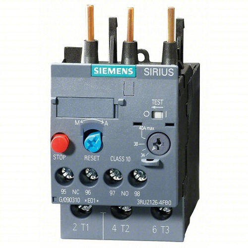

Siemens overload relay
Figure 2. Overload relay displaying the ‘Class 10’ rating. Image used courtesy of Grainger, device made by Siemens
Motor Overload Relays
Now that we understand trip curves, the idea of an overload trip class is quite similar.
Overload trip classes appear most often as class 10, 20, or 30. These numbers relate to the number of seconds that the overload will maintain contact if an excessive inrush current is experienced.
If the current is 6x the full-load amps of the overcurrent relay, the class 10 device will trip after 10 seconds, class 20 after 20 seconds, and class 30 after 30 seconds.
The design choice is made based on the expectation of the motor. Some motor situations can easily survive excessive current for a few seconds at startup, and it’s not unexpected, so it would be a nuisance to have to resent breakers constantly to start a process.
