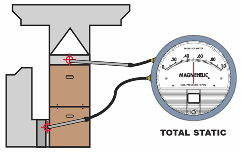

Different Pressure Profiles
Pressure profiles create areas with high and low pressures where the air flows from the high-pressure area to the low-pressure area. Typically the rooms with the critical processes such as manufacturing or filling are kept at a higher pressure than the area where packaging takes place, which remains at lower pressures.
Figure 2. Reading pressure must happy at specific parts of the airflow system. Image courtesy of York Central Tech Talk.
This condition protects the product at critical stages such as manufacturing from exposure to contamination due to air coming from the surrounding areas.
