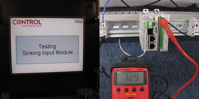

Input Modules
If the module in question is an input module, it can easily be tested by using an inline ammeter - like the ‘mA’ or ‘A’ terminals in a standard digital multimeter.
  • Place the red (+) clamp of the ammeter on the input terminal you wish to test.
  • Place the black (COM) clamp in the following locations:
    • For a sourcing input module, place COM on the - voltage supply. You should see a (positive) value on the order of 5-50 mA depending on the model, Figure 2.
    • For a sinking input module, place COM on the + voltage supply. Here you should see a (negative) value, again on the order of 5-50 mA, Figure 3.
Sourcing Input
Figure 2. Testing of a sourcing input module.
Sinking Input
Figure 3. Testing of a sinking input module - be sure to note the negative (-) sign on the meter.
If you see no current, but the module wiring and meter are properly connected, then you most likely have a failed input terminal, or entire module.

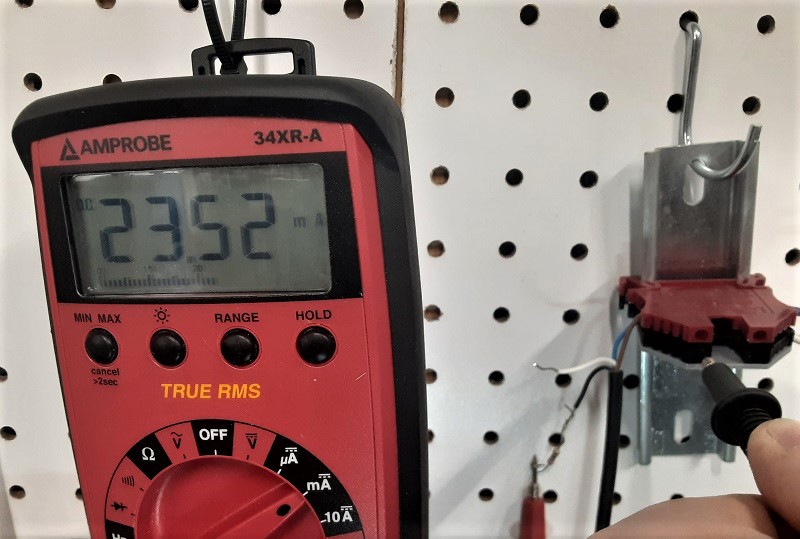

If the supply voltage is proper, we can turn to the ammeter again to test these sensors.
Note that the sensor will turn on and off as it is activated. If the sensor is de-energized, the current should be zero. Place an object in front of the sensor, simulating real-world conditions, and the current should begin flowing. Most sensors have helpful indicator LEDs to show the energized state.
Use that 1 kOhm resistor from before and attach one end to the sensor load wire (usually the black wire on a pigtail or quick-disconnect harness).
  • Place the red (+) clamp of the ammeter on the resistor’s free end.
  • Place the black (COM) clamp in the same locations as with the control modules:
    • For a PNP sensor, place COM on the - voltage supply. You should see a (positive) value around 24 mA, Figure 6.
    • For an NPN sensor, place COM on the + voltage supply. Here you should see a (negative) value, again around 24 mA.
PNP sensor test
Figure 6. Testing a PNP Sensor - current goes out through the load wire, through the 1 kOhm resistor, into the ammeter, and finally back to the power supply negative, showing ~24 mA.
