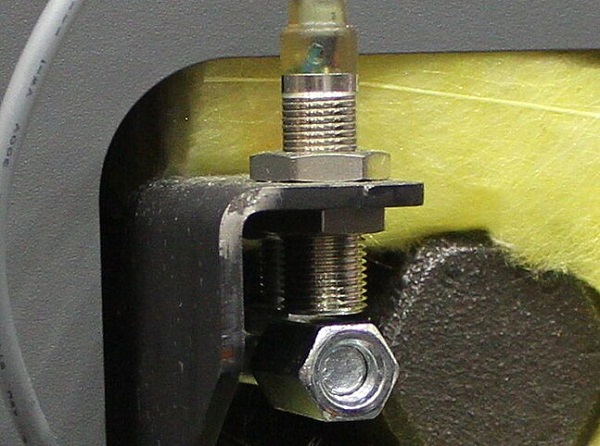

A metal proximity sensor detecting a part
Figure 1. Part presence using inductive metal sensing. Image used courtesy of Wikipedia

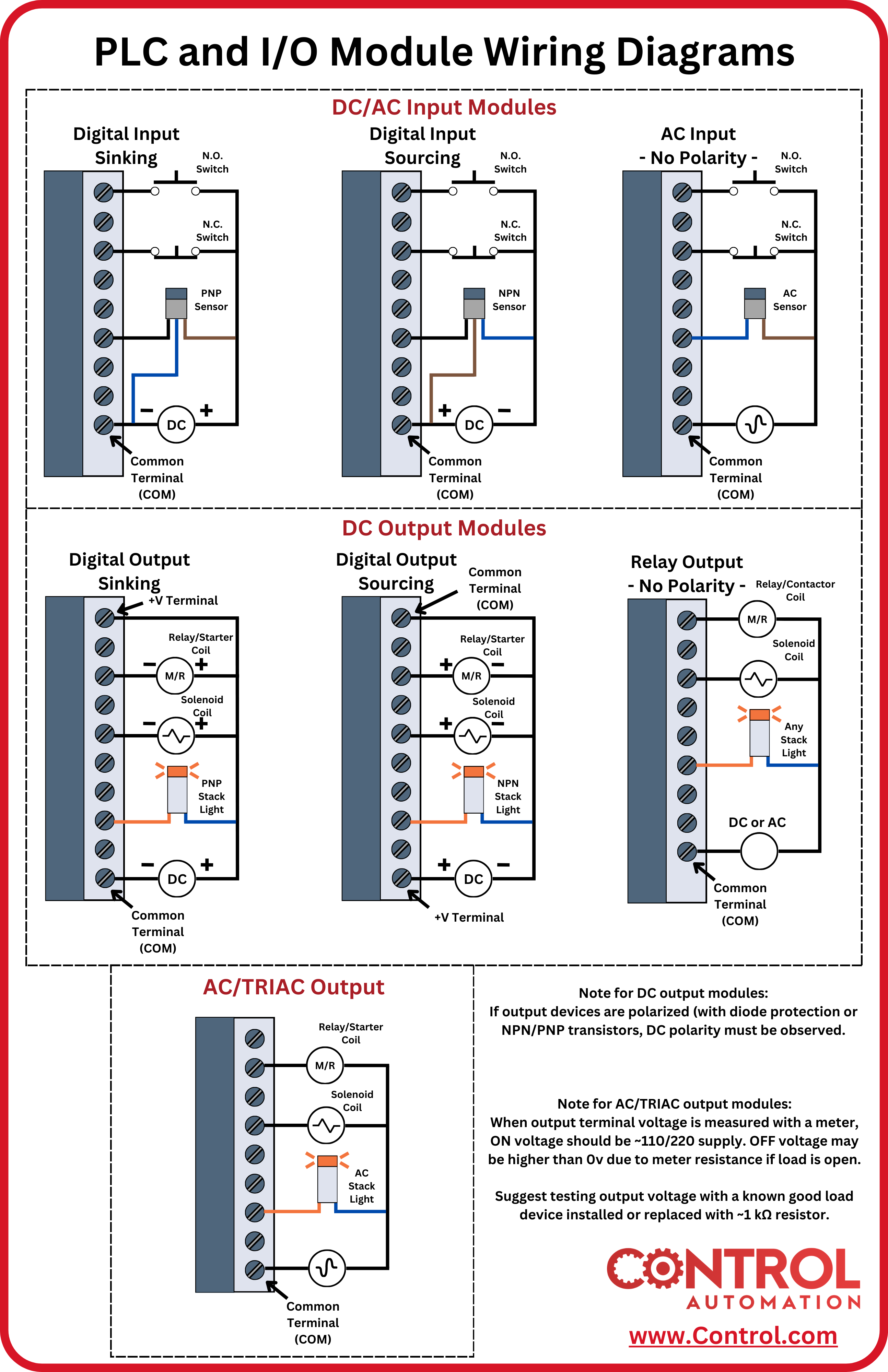

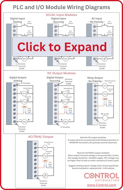

Sinking Vs. Sourcing Modules
Both input modules and output modules can be sinking or sourcing, and it’s critically important to know if the module you are troubleshooting is sinking or sourcing. The terms sinking and sourcing dictate the direction of the current flow, and for further details, they are covered quite extensively in many articles.
If the output module provides voltage from each output terminal when that output is switched ‘on,’ that is considered sourcing (the most common output type).
The same logic applies to inputs but usually in the reverse direction. When voltage is provided to the input terminal when ‘on’ is detected, that is considered sinking (the most common input type).
You can usually tell if a module is sinking or sourcing by checking the polarity of the common connection. If the input module has a common ground (-V), you have a sinking module, but if the module has a common supply voltage terminal (+V), you have a sourcing module. Always consult the manual to make sure you know the type of module you are using, since many digital modules require a common connection to both voltage and ground, so first impressions may be deceiving.

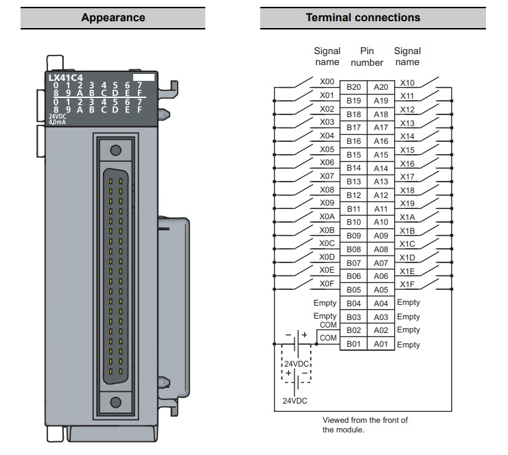

When dealing with a sinking input module, you must determine if there is actual, physical voltage at the input, and not simply rely on assumptions or LEDs dictated by the CPU logic. This can easily be done with a multimeter on the proper settings.
Terminal wiring for a typical input module
Figure 3. The proper wiring diagram for an input module. This module can be configured for either sourcing or sinking by reversing the power supply connections (bottom-left of the right-side image). Image used courtesy of Mitsubishi Electric (page 36)
  1. Configure your multimeter to read the correct voltage, either AC or DC, according to the electrical drawings.
  2. Place the positive probe in the terminal on the input module and the negative probe to ground
  3. Activate the input device (press the push button, close the relay, or flag the sensor)
    1. If using a sinking input, you should see voltage at the input terminal. If not, follow the same steps for each device in the upstream circuit until you find the device that is not completing the circuit (open).
    2. If using a sourcing input, switch the meter to the continuity test function, and you should hear a beep and see low resistance. If not, measure the voltage across each device in the downstream circuit until you find the device that is not completing the circuit (open).

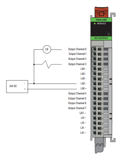

Troubleshooting output modules is similar to inputs, although most outputs are sourcing. You need to reference any electrical drawings and manuals to understand what type of device you are working with, and the type of voltage the device uses. With a sourcing 24 VDC output module, you will want to check for 24 volts at the terminal, referenced to ground when the output is ‘on.’
Wiring diagram for a PLC output module
Figure 4. The proper wiring diagram for a sourcing output module. Voltage may be measured directly at ‘Output Channel 0 (through 3).’ Image used courtesy of Rockwell Automation
Outputs can be forced on or temporary logic can be used to toggle on outputs for testing purposes. If your multimeter is showing 24 volts at the terminal when the output is on, then you will need to inspect further downstream to find where the circuit is not completing. Sensing voltage at the terminal but not at the device could happen because of a faulty connection at a sensor or terminal of a relay.
Never, ever connect an output terminal directly to ground or the negative DC supply as this creates a short circuit and internal damage could occur. You always need to have a resistive load between the output terminal and ground. In summary, the output module needs to see a completed circuit from the output terminal to the common terminal
