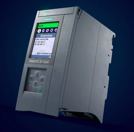

The Marque And Display Screens
For many of the latest generation controllers, there is often a marque that can display messages that provide very descriptive troubleshooting hints directly on the device.
The latest revs of the Allen Bradley CompactLogix and ControlLogix families of PLCs have a small marque that displays the PLC name, the program running on the PLC, and the status and IP address of each Ethernet port. If a mapped Ethernet module stops responding the marque will display an I/O fault. The Productivity PLC series from Automation Direct provides a similar multi-line LCD text screen for diagnostic information.
Some newer PLCs have integrated full-color LCD displays and keypads so that maintenance staff and integrators can scroll through very descriptive fault and warning messages and configure some settings. The Siemens S7-1500 PLC series offers this type of display and keypad right on the front of the CPU module.

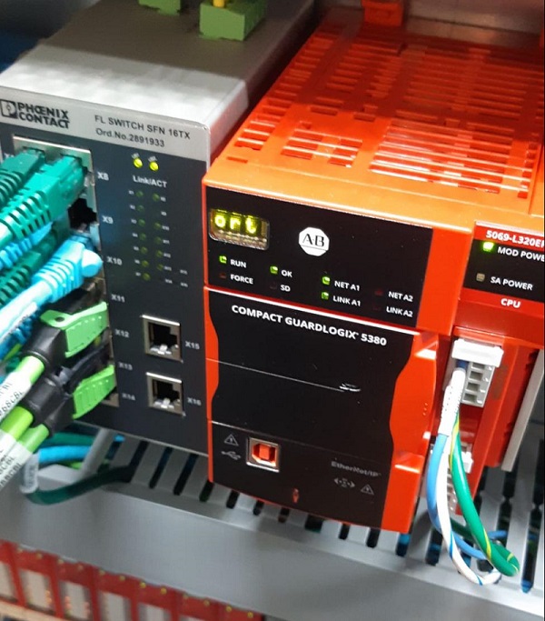

Status / Error LED
Most PLCs include an LED to signify the presence of errors or if the processor is otherwise operating abnormally. Some manufacturers call it the S/E LED or the Error LED, but either way, a solid or flashing red error LED points to something wrong with the PLC or a problem with the installed program.
In the case of the B&R X20 PLC, the S/E LED will flash between green and red, and the sequence of the flash will help determine the cause of the error. For example, if the S/E LED is red for a long pulse followed by two short pulses and another long pulse, with a two-second pause in between, a hardware error is reported. If your PLC follows such a code pattern, you will certainly need to consult the documentation to interpret these error or fault status indicators.

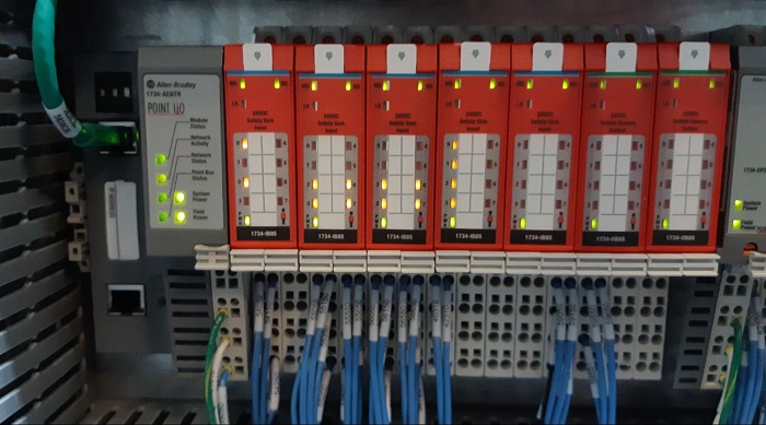

Remote I/O module status LEDs
Figure 3. I/O indicators can be seen on the front of both local and remote I/o modules. Image used courtesy of the author
I/O Status LEDs (On the Modules)
Most inputs and outputs will have at least one indicator per channel to show the status of that port. Discrete (digital) modules will simply illuminate or not, depending on the port status. Analog terminals are a bit trickier, and any LED indicator will only present power information, not the actual value of the analog signal.
Local Discrete I/O Points
For input modules, the LED will light up when an input is detected, and for outputs, the LED will light up when the output is turned through the program, even if nothing is connected to the output.
If the input LEDs respond properly, but the output LEDs never update, the PLC may be in ‘stop’ mode. If the output LEDs respond properly, but the actual output devices do not energize, turn your attention to examining the output wiring to identify the problem.
Safety I/O Modules
If you are using safety-rated modules, there will be some internal checking for proper configuration and wiring to test points. If test points are being used, the proper test point needs to be wired to the correct input channel. If something is incorrect, the output or input channel LED will be red.
Once again, some manufacturers will flash the red LED in different sequences to help diagnose the problem without programming software.
Remote I/O Modules
With remote or expandable I/O modules, there is often an LED indicating the bus communication status. If a module is added to the backplane without updating the configuration, the whole I/O module will become unresponsive and the bus indicator LED will change color. The same event will occur when a module is removed without proper configuration adjustment.

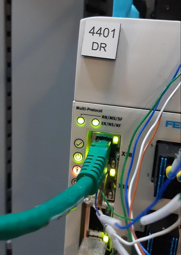

Communication Modules
Many devices have communication modules embedded in the CPU, typically with a separate set of status LEDs just for communication. There are two LEDs per communication port, one for link status and speed, and one for packets transmitted or received (Tx/Rx). When the device is plugged into a network, the link light should be solid green or yellow. The Rx/Tx LED flashes rapidly as packets are transmitted and received.
With Ethernet communications, the device needs an IP address before it can begin transmitting or receiving data packets. When a new device is plugged into a network, the link light might be green or yellow with the Rx/Tx light remaining off until an IP address is set.
Industrial devices will sometimes have a feature for locating them physically by using the status LEDs. When triggered, both the link and Rx/Tx LEDs will flash at a constant frequency.
If the link LED is solid, but there is no activity after you have set your IP address, confirm that the IP address is in the subnet range of all other devices and that there are no firewalls or VLANs preventing communication.
