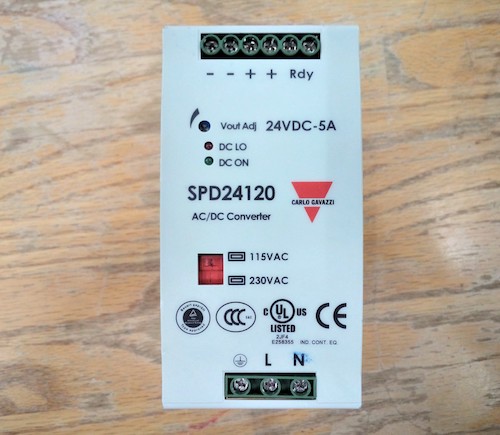

Figure 1. Most industrial power supplies use 1- or 3-phase input power. They also often have a voltage adjustment screw terminal, indicated here with ‘V ADJ’ with the curved arrow.

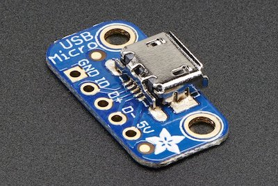

Sometimes testing the output is difficult, like on a phone charger USB cable. The terminals are extremely difficult to access. However, most of these tiny, inaccessible power supplies are very inexpensive, and replacement is the most obvious choice. If testing is very important, breakout boards can be purchased. These boards turn the tiny cable into a larger prototyping board with terminals than can be easily reached. I try to keep a couple of these types of boards around in my shop all the time.
Figure 2. Breakout board for testing supplies that do not have easily accessible terminals. Image courtesy of Adafruit

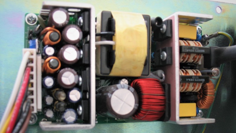

Figure 3. This linear power supply has a fuse (center) in-line with the transformer on the right side, clearly visible primary and secondary terminals, the bridge rectifier at the top, and a capacitor on the left. This type of supply would be quite expensive, and the ease of component replacement might make a favorable repair.

    However, I have a query about the photo which is supposed to depict a “linear power supply”.
    Looking at the number of chokes, and what appears to be a high frequency transformer instead of an iron cored mains transformer, I suspect that this is a switchmode power supply of some sort.
    Kind regards, Roger Valmadre.
