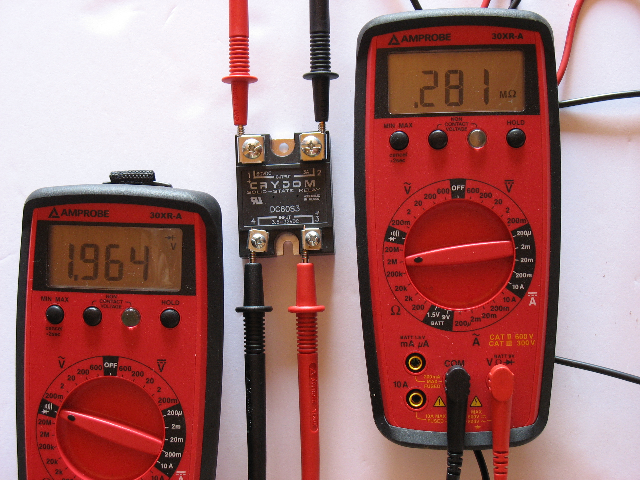

The diode test function can still work on a variety of DC output solid-state relays. When the relay is ‘off’, the output is open, and shows a very large voltage drop.
When turned ‘on’, the voltage drops significantly, but is still more than 0. The only problem is that for higher currents, the internal resistance of the transistor decreases. Since the meter only outputs a small current, it might not be enough to drive the meter into a range that can provide a valid reading, and may still show OL.
To use this test, place the red lead of a second meter on the ‘+’ output terminal, and the black lead on the other terminal. While the first meter is performing the diode test on the input, check the output. If this test works, then it should show OL when the input test leads are removed, then a voltage of no more than 2.0 volts then the input leads are returned.
Using resistance tests, the output terminals can often be given an initial assessment. With the input terminals ‘off’, the resistance of the output shows an OL or open circuit.
The other test which may come in handy is the resistance test. Again, while the first meter is measuring the input terminals in the diode test function, measure the resistance of the output terminals with a second meter. They will likely remain at a shockingly high resistance, but this is only because the resistance decreases substantially at the higher operating current, not the meter output current.
When the leads are removed from the input terminals, the resistance should climb to OL, indicating an open circuit. When the input leads are returned, the output resistance may drop down into the low MΩ or kΩ range. In actual operation, it will drop far lower than this, but it is only a test to indicate functionality.
When the input is energized, the output resistance drops in value. Note: the resistance is dependent on the current sent to the load - do not expect your meter to show a very low output resistance, even when the relay is energized.
The same warnings that applied to inputs still apply to outputs. Not every meter will supply the same output values for each test. Do not assume that because these tests work with one meter, they will work for all. AC output relays will be harder to test, but I have still been able to measure resistance values for some of them, using the same method as provided above.
