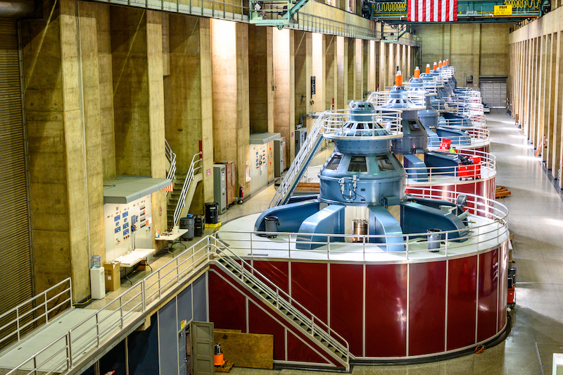

The infrastructure needed in power generation tends to be large in scale compared to what we normally find in industrial automation and the manufacturing sector. This includes the turbines themselves, especially within windmills and hydroelectric plant turbines.
Hydroelectric plant turbines are comparatively massive in scale
Figure 2. Hydroelectric plant turbines are comparatively massive in scale. Image used courtesy of Adobe Stock
The sheer size introduces many engineering challenges, but large parts rotating at high speeds require additional dedication. This is where turbine ratcheting becomes necessary.

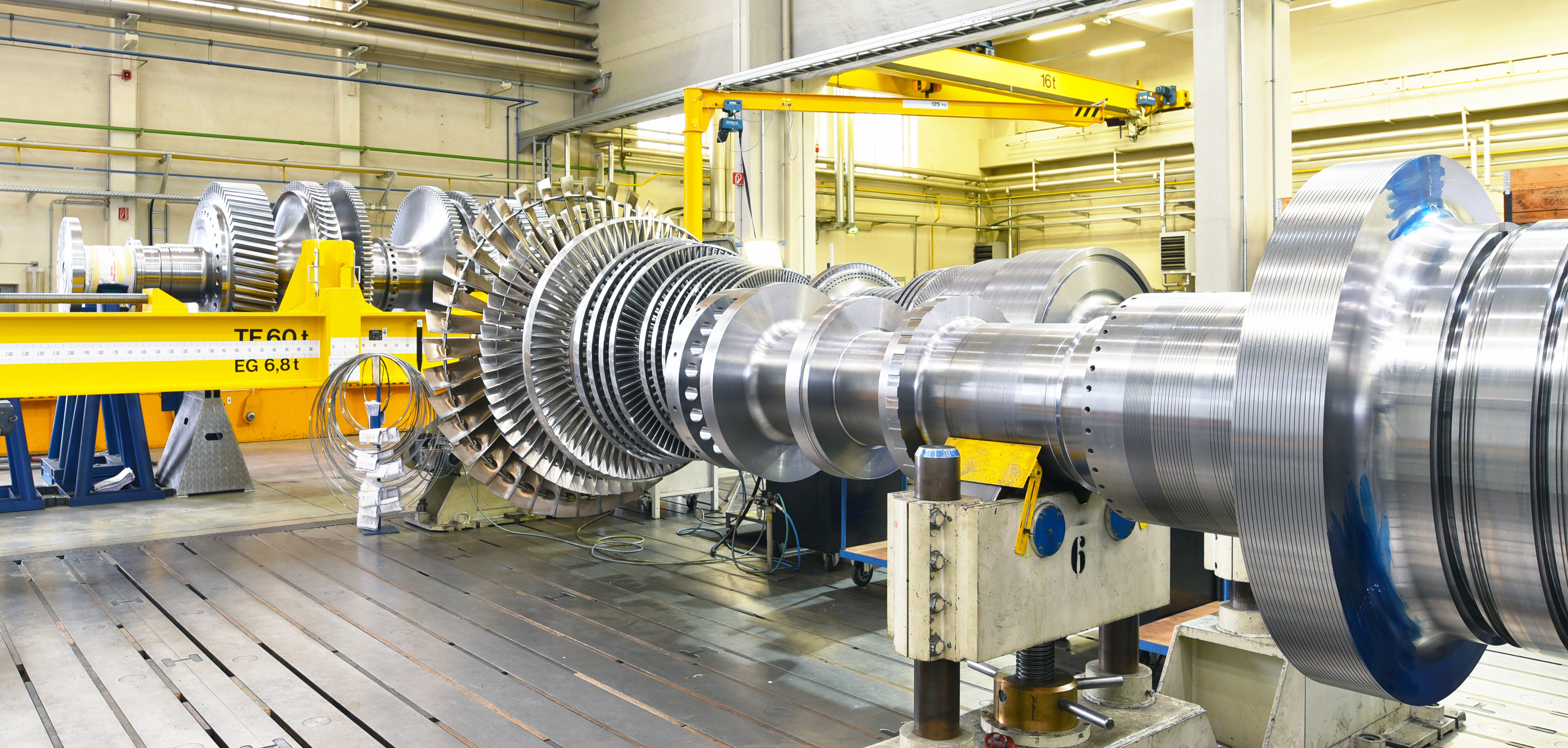

Consider a steam turbine at a power generation plant. In this case, fluid going through the turbine engine generates work (in physical terms, force x distance). By inducing the rotational motion of the machine, this work alone creates a temperature differential between the inlet and the outlet of the engine. A large portion of the energy from the flowing steam is transferred to the engine in the form of motion.
Also, the steam is heated to a temperature of at least 540 °C. In this superheated condition, the steam creates temperature differentials between the inner and outer components of the engine. The turbine shaft at the center receives the brunt of the heat transfer, while the outer casing is normally exposed to the temperature in the atmosphere but still receives some of the energy conducted from the steam inside. These temperature deltas allow each steam turbine component to expand and contract differently. Minimizing this temperature differential and its effects is an important consideration during the design and operation of a steam turbine.
emperature and pressure differentials in steam turbines explained
Figure 3. Temperature and pressure differentials in steam turbines explained. Image used courtesy of Adobe Stock

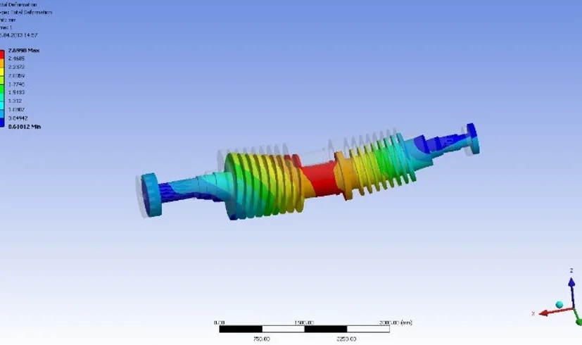

A turbine should not be abruptly stopped and left stationary because heat transfer is still occurring. If this happens, machine cool-down will be uneven, potentially leading to permanent deformations.
One type of deformation is called sagging. It occurs when the rotor bends downwards due to the combined effects of gravity and heat expansion.
Simulation of a turbine that has suffered excessive sagging
Figure 4. Simulation of a turbine that has suffered excessive sagging. Image used courtesy of Istrate Energietechnik
The other type of deformation is called hogging. The effects of temperature also cause this, but the effects of gravity are exerted outwards, bending the rotor shaft up.

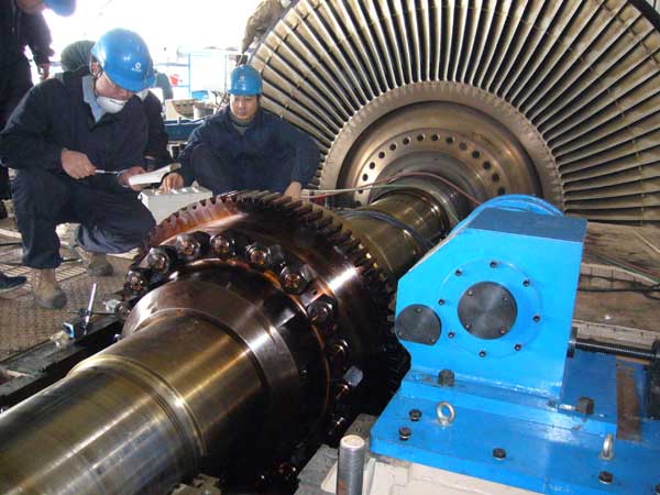

Both sagging and hogging occur to some degree, but it is crucial to minimize the deformation as much as possible. This is achieved by employing a turning gear. Turning gear operation is also referred to as ratcheting. Turning gear operation, or ratcheting, has two main purposes: to reduce hogging and sagging and to allow a soft and uniform temperature change.
The turning gear operates before the machine startup and immediately after shutdown. During the startup process, the turning gear must be turned several hours before reaching full system capacity. The duration of the prewarming phase depends upon the turbine’s characteristics. The turning gear will help to straighten the rotating shaft and eliminate concentricity errors created during the previous work cycle. The turning gear must operate for the minimum recommended duration; otherwise, running the turbine with eccentricities and deformation can cause serious damage.
A turning gear mounted on a steam engine
Figure 5. A turning gear mounted on a steam engine. Image used courtesy of Sogears Manufacturing
Conversely, during the shutdown process, the turning gear engages and keeps the turbine rotating until the temperature has decreased to a set level at which the rotor can be left motionless without any damage. Some turbines take several hours and even days to reach that setpoint. Once the rotor has completely stopped and the turning gear disengages, the machine can be powered off and serviced. Normally, the turning gear is started up ahead of the turbine shutdown to allow both the main rotor and the turning gear to reach a low speed for the ratcheting to engage.
