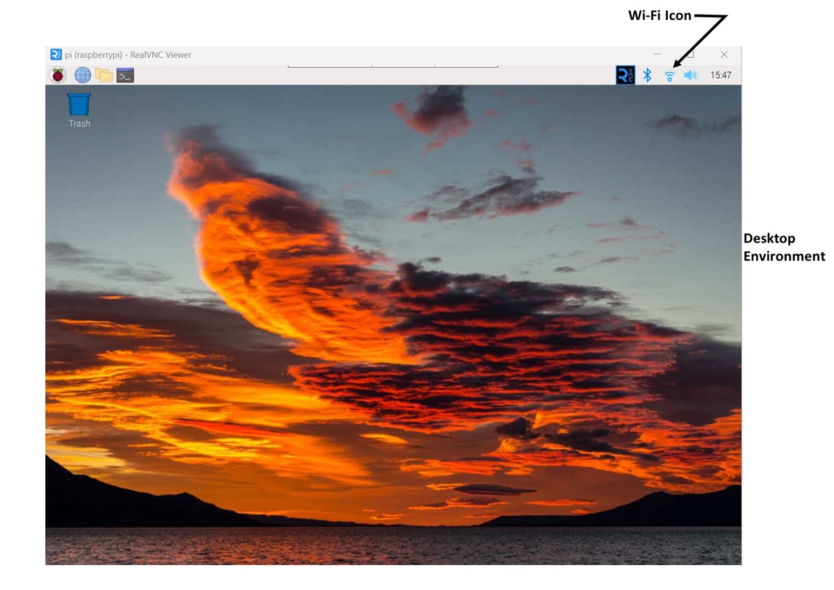

These parameters are created when the structured text (.st) file is compiled and downloaded. The runtime web server is accessed using the Raspberry Pi’s IP address followed by ';' and the port number 8080. Point your mouse to the Wi-Fi icon near the right of the toolbar in the PI desktop environment to find the IP address. The IP address will appear in a popup window.
Raspberry Pi desktop wifi access icon
Figure 2. Location of the Raspberry Pi Wi-Fi icon

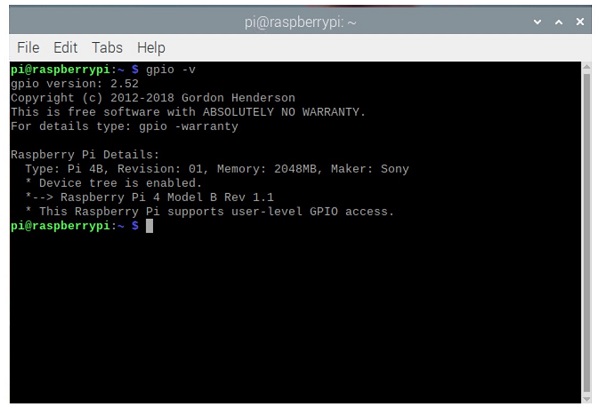

The OpenPLC runtime needs to access the general-purpose I/O (GPIO) pins. Recent Pi platforms (version 3 and newer) already have this library included, but to verify, open the terminal and type the following:
gpio -v

This should finish the process, but at this point, run the ‘gpio -v’ command and see the newly installed details for your Pi platform. It should look much like the image below:
Successful install of the WiringPi library
Figure 3. Successful build of the WiringPi library

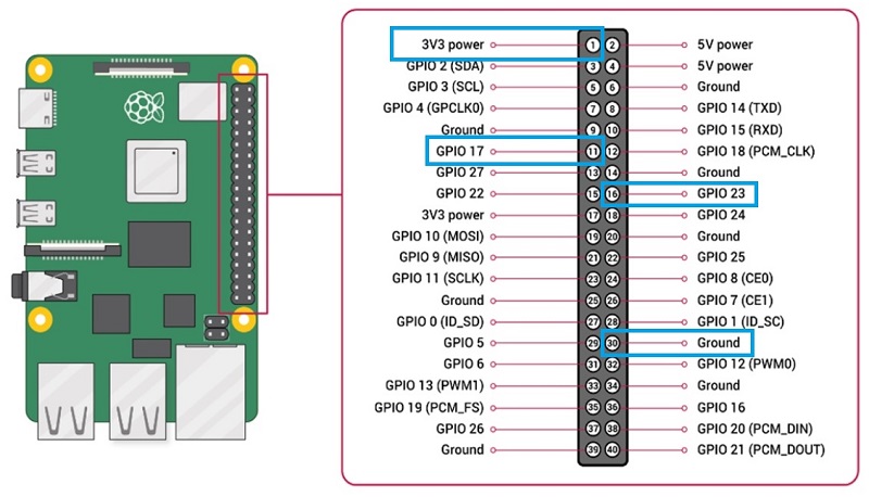

In the other format, the 40-pin header is numbered vertically with odd numbers on the left and even numbers on the right. OpenPLC uses the GPIO pins on the left as inputs, so pins 3, 5, 7, 11, and 13 (mapped to GPIO pins 2, 3, 4, 17, and 27) will constitute the input tags IX0.0, IX0.1, IX0.2, IX0.3, IX0.4, and so on.
For the outputs, in a similar fashion, pins 8, 10, 16, 18, and 22 (GPIO 14, 15, 23, 24, and 25) equate to output tags QX0.0, QX0.1, QX0.2, QX0.3, QX0.4, and so on.

Figure 5. Raspberry Pi 4 pinout. Image used courtesy of Raspberry Pi, modified to highlight the pins used in our project

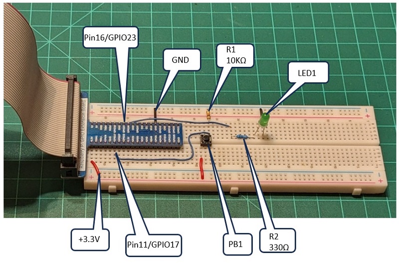

The pushbutton circuit will use a tactile switch with a 10kΩ pulldown resistor. The output indicator circuit consists of a 330Ω resistor wired in series with an LED.
At the simplest level, individual wires can be inserted into the 40-pin header connector and attached to the pushbutton switch and the LED circuit mounted on an external breadboard.
Another approach to attaching the pushbutton switch and the LED circuit to the Raspberry Pi uses an extension board (shown below) that breaks out the Raspberry Pi I/O pins on a T-shaped PCB. The extension board is inserted into an appropriate length/size solderless breadboard, allowing the pushbutton switch, pulldown resistor, and LED circuit to be easily attached to the Raspberry Pi without the bulk of many jumper wires.

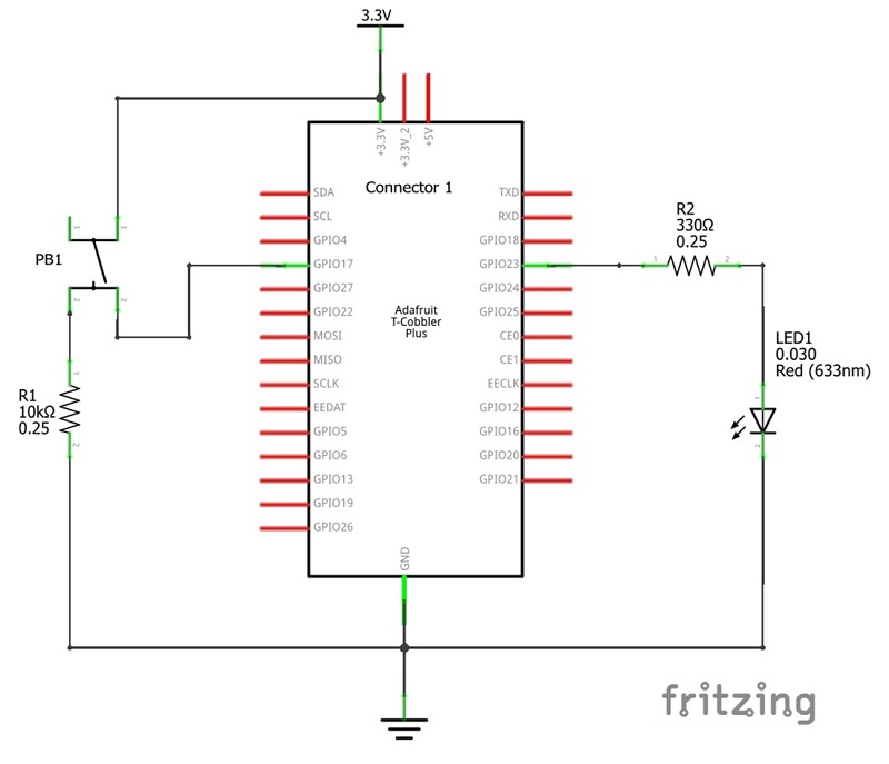

As an additional electrical wiring reference, an electronic circuit schematic diagram is provided.
Schematic for PLC circuit
Figure 7. Raspberry Pi PLC schematic diagram
The extension board physically connects to the Raspberry Pi using a flat ribbon cable allowing voltage (+3.3V), ground, and I/O control signals to be electrically attached to the Raspberry Pi 40-pin header connector. The flat cable allows the arrangement of the solderless breadboard to be conveniently placed on the workshop table or lab bench.
The wiring assembly of the breadboard below illustrates the electrical parts wired to the extension board. If an extension breakout board isn’t available, you can use jumper wires to directly connect to +3.3V, GND, pin 11 (GPIO17), and pin 16 (GPIO23) right on the header of the Pi.
Image of breadboard with components installed
Figure 8. The Raspberry Pi based PLC circuit with an expansion board

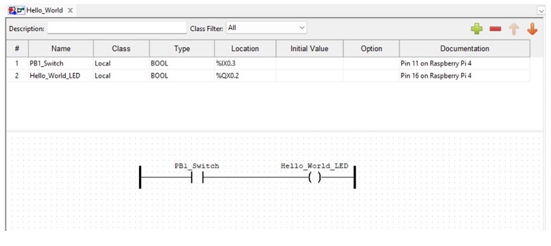

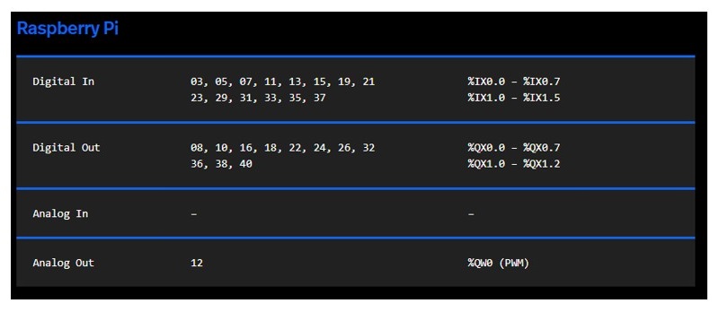

The Hello World Ladder Diagram (LD) presented in the Arduino OpenPLC introduction project can be easily modified for the Raspberry Pi controller. The primary modification of the LD involves applying the SBC physical I/O addressing scheme to the Raspberry Pi. The I/O address reflects the body-pin format, not the GPIO designation. With this approach, the assigned tags will ensure that the target pushbutton switch's input and output control signals and the LED circuit will be initiated correctly.
Mapping I/O tags to physical pins on the Pi
Figure 9. The Raspberry Pi Physical Addressing. Image used courtesy of Autonomy Logic
As with the Arduino ladder logic project, the Hello World LD and the Tag listing table are built within the OpenPLC editor.
Ladder diagram and tag table
Figure 10. The Raspberry Pi ‘Hello World’ LD/Tag Listing Table

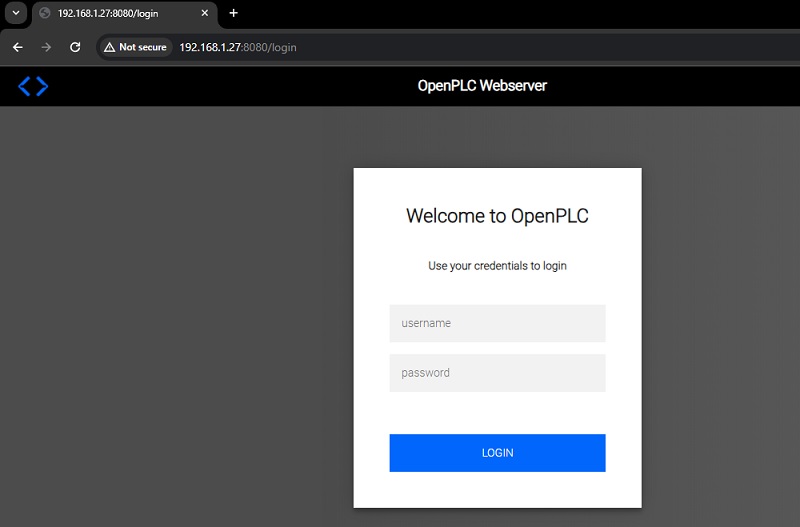

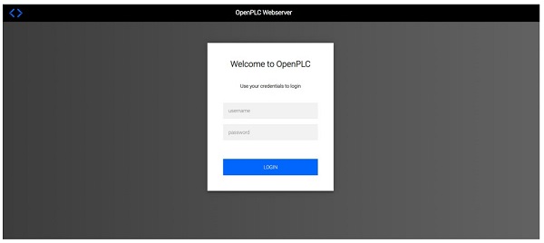

The default login username and password are both openplc. It is suggested that you change the login credentials to ensure the security of your LD programs.
OpenPLC webserver login screen
Figure 11. The OpenPLC Webserver login screen

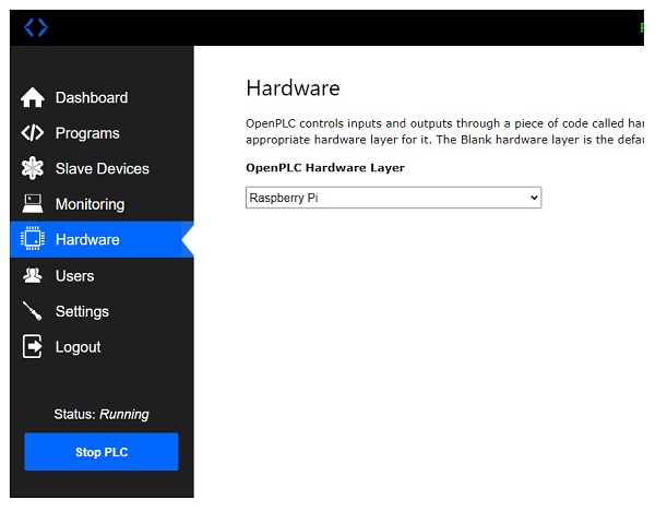

Back in the webserver, click on the Hardware button, select the Raspberry Pi as the hardware layer, and Save changes.
Selecting the correct hardware platform
Figure 13. Selecting the Raspberry Pi hardware

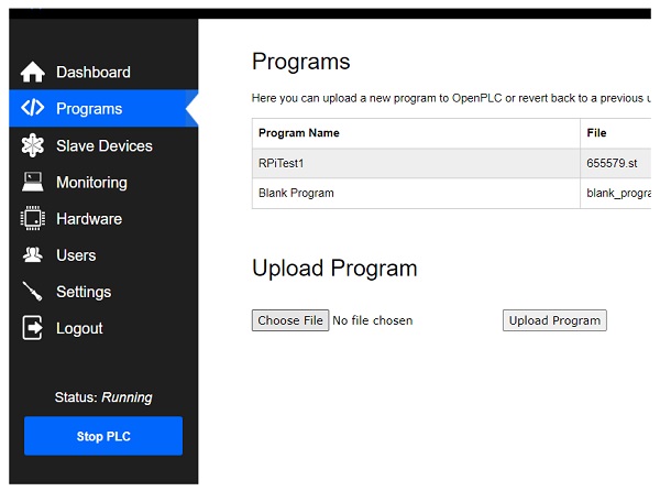

To upload the .st file, click on the Programs button on the left side of the OpenPLC web server panel.
A window will open where the .st file (program) can be uploaded to the web server. Click the Choose File button, select the Hello World.st file, and then click Upload Program.
Uploading the .st file to the Raspberry Pi
Figure 14. Selecting and uploading the .st file
The compilation process of converting the .st file to a C++ program will be visible. The Hello World program will be displayed on a table after completing the upload/conversion process.

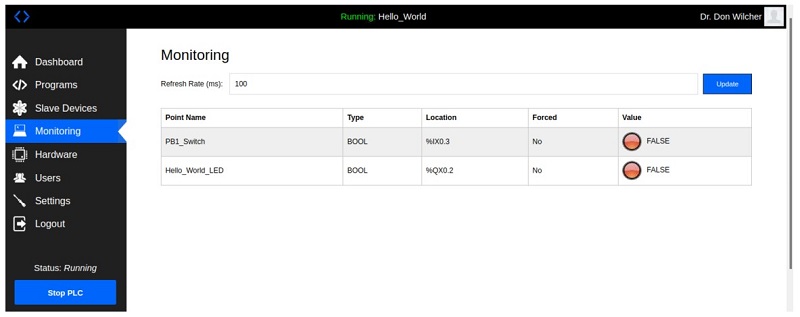

With the Hello World program uploaded to the Raspberry Pi, click the Dashboard button with the mouse at the bottom of the web server’s window. Click the Start PLC button on the left side of the panel. The execution process of the program will be visible in the window.
Monitoring the status of the I/O pins
Figure 15. The ‘Hello World’ monitor dashboard for the Raspberry Pi
The status of the pushbutton switch and the LED can be observed using the Monitor. Click the Monitor button with the mouse to observe the actions of the pushbutton switch and the LED. With each press of the pushbutton, the LEDs will switch from red to green. The monitor can be a diagnostic human-machine interface (HMI) tool to virtually watch the Raspberry Pi PLC I/O's physical operation.
