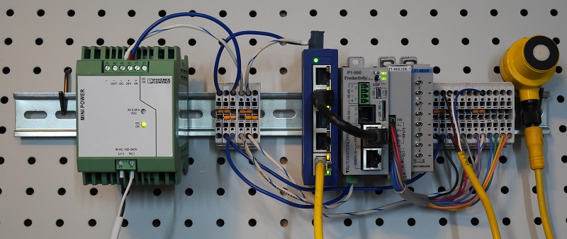

Productivity training bench
Figure 1. A training bench setup for practicing analog signals using an AutomationDirect PLC. Image used courtesy of the author
The PLC is a P1-550 from the Productivity1000 Series from AutomationDirect, a nice PLC for learning due to its relatively low cost and the free programming software. A combination analog I/O module is used, the P1-4ADL2DAL-1.

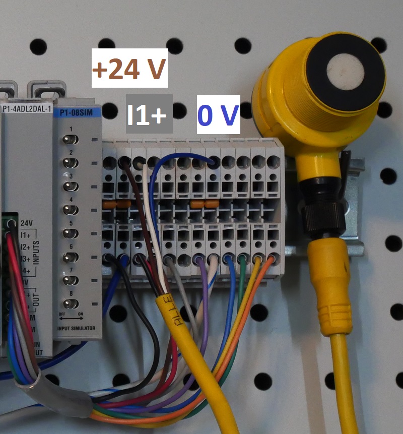

The module itself needs 24 and 0 volt supply connection from an external power supply, and the input current signal from the sensor. According to the wiring diagram, the sensor also needs +24 volts (brown wire) and 0 volts (blue wire), and the white wire from the M12 connector cable transmits the signal to PLC module I1+.

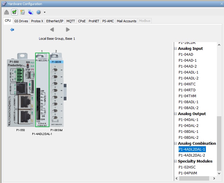

Adding the analog module is quite simple, we just drag and drop the correct module into the proper position. In my setup, I also include a digital input simulator for simple projects, but this is not necessary for analog signals.
Adding a new module to the hardware configuration in Productivity Suite

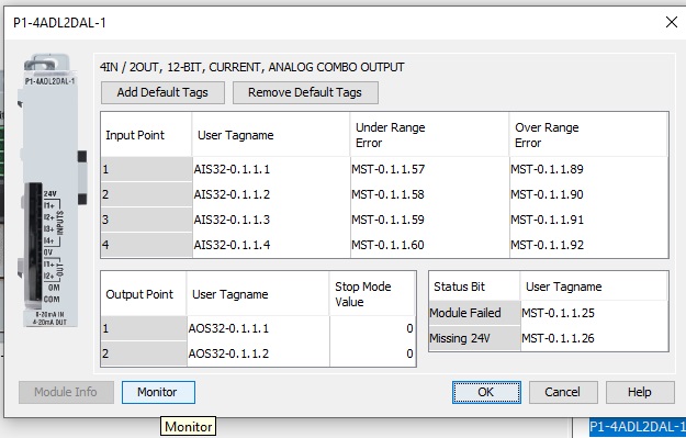

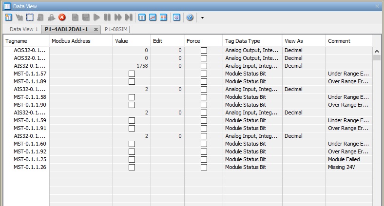

When we add the module, be sure to ‘Monitor’ the tag values so that we can see a live readout in the ‘Data View’ tab. This is important because, unlike discrete inputs, which trigger by a pre-determined event taught at the sensor, we must read the data to know what input values relate to what scaled output.

In the ‘Data View’ tab, I can see the live value of the sensor all the time. As I move the sensor closer or away from a flat wall, I can see the sensor value ranging between about 1520 when I’m 6” away from the wall, all the way up to 8191 as I hit 32” away from the wall.
Live view of tag data in Productivity Suite
Figure 5. Live tag value in the ‘Data View’ tab. Image used courtesy of the author
Why doesn’t it go to 0? The sensor outputs a minimum of 4 mA, but the module can read as little as 0 mA, so I cannot reach 0 mA, no matter how close I get to the wall.

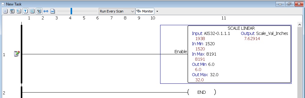

In the first line of my ladder program, I use a scale command, which requires an input of 6 values:
The input tag (the tag from the Analog In 1 terminal)
The output tag (I created a float called “Scale_Val_Inches” for greater precision)
Input minimum = 1520, the smallest value from the sensor
Input maximum = 8191, the largest value from the sensor
Output minimum = 6.0, the real-world value when the sensor value is the smallest
Output maximum = 32.0, the real-world value when the sensor value is the largest
Ladder rung with Scale command in Productivity Suite
Figure 6. The linear scale command. Image used courtesy of the author
Once we have this program downloaded, the new float tag value will accurately display the actual distance from the sensor to the object!
