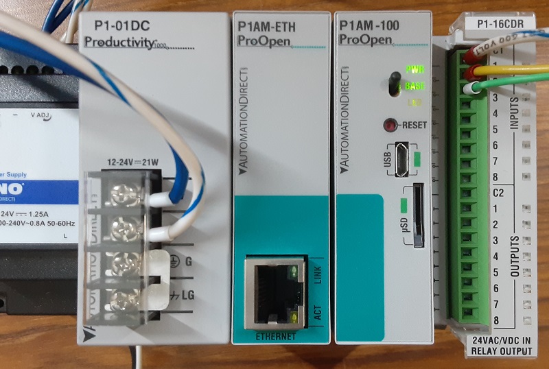

Bench setup for ProOpen tutorial
Figure 1. My bench setup includes a power supply, Ethernet adapter, CPU, and I/O module. You can complete this project with just the CPU and I/O module!

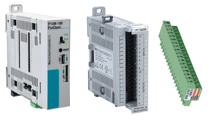

This project, while not as costly as some PLCs on the market, still requires a couple of items to succeed. We will be using the P1AM-100 CPU and a combination input/output module, the P1-16CDR. In my setup, I also have included an Ethernet module and a power supply, but this introductory project will succeed without these.
In addition to the PLC itself, we also need a 24 volt power supply and micro USB cable that includes both power and data (your computer should register a new device in the device manager).
Since the programming uses the Arduino software, you can program this PLC on Windows, Mac, or Linux! This tutorial was tested on software version 1.8.19 (scroll down and find the ‘Legacy IDE’ button on the download page). I personally have not tested it on the newest version 2.0 platform from Arduino.
The hardware setup is very simple. The I/O module is attached on the right side of the CPU and fixed to the DIN rail. The power supply is connected, and I powered up the 24 volt supply before connecting the USB cable to the CPU.
Required project hardware
Figure 2. Required hardware: the P1AM-100 CPU and the P1-16CDR I/O module, along with a terminal block for wiring.

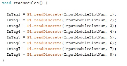

Subroutine: readModules
In a typical PLC scan, the status of all input points are detected before executing any logic. This simple subroutine will obtain all input addresses on this combo module (it has 8 inputs and 8 outputs).
If other modules (even analog inputs) are added to the project, they can also be added to the readModules routine.
Reading the input modules
Figure 5. This subroutine reads all of the input module points. For convenience, we define the slot number at the very top of the program.

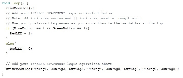

Main Routine: loop
The main routine performs three basic tasks in this order:
  1. Runs the readModules subroutine
  2. Checks all logic instructions in our code
  3. Runs the writeModules subroutine.
In step 2 is where our only code editing needs to take place, between the indicated // comment marks.
Rather than re-hash this If/Else statement logic, have a look at our previous article, describing how to recreate ladder logic in a C++ coding environment.
For my simple test, the code examines both the red and green buttons, if both are energized, the output LED will also energize.
The actual code logic
Figure 6. The main routine actually executes the user-defined logic. It doesn’t need to be ladder format, but that can help.

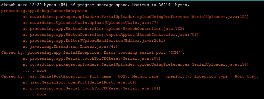

COM error in Arduino IDE
Figure 8. A possible COM error when loading a code.
Restart the Arduino IDE
Some errors exist because the COM port is currently in use from an existing project. Closing and opening the IDE can clear some problems and refresh board and port identifications. If this doesn’t work, move on to the next step.

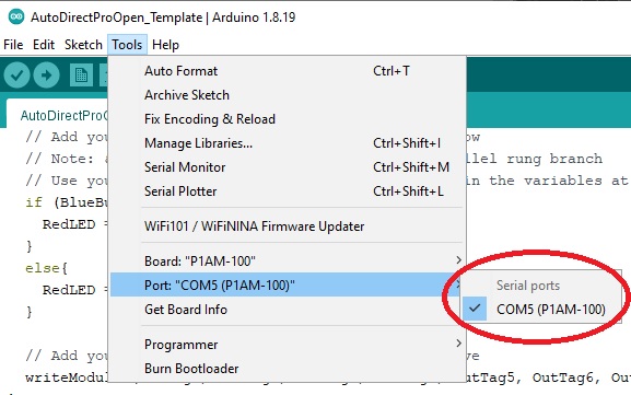

Board and port ID in Arduino IDE
Figure 9. This shows the proper selection of the board and port for a Windows machine.
COM Port Number
If the program reports an error during the loading process, verify that the board is selected properly, and that the COM port is also correct. The following image shows the correct values (although your COM port number may be different).

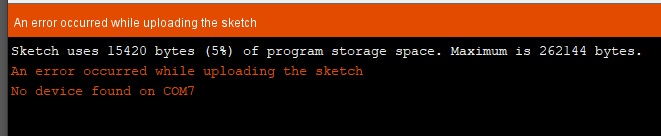

Bootloader error in Arduino IDE
Figure 10. If this error is encountered, double-tap the Reset button, select the COM port, and upload again.
Reset Button for Bootloader Mode
When loading a program, there can be errors in communication. Compared to the familiar Arduino Uno board, there are differences in the chips that handle the translation between the USB and serial communications for the CPU. Simply pressing ‘Upload’ again or restarting may not solve the problem.
A common fix is to press the ‘Reset’ button on the CPU 2x times quickly, then select the proper COM port (it might change), and upload one more time.
