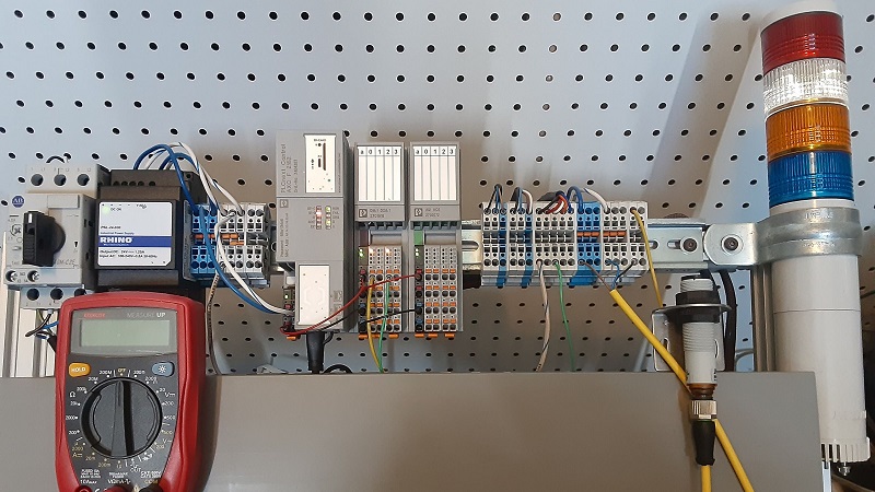

Test bench for the PLCnext
Figure 1. My first test bench setup for the PLCnext with one digital input and one digital output.

In this relatively simple example, we will need only the PLCnext controller and one I/O module. I have used the AXC F 2152 controller and the AXL F combination module with 8x inputs and 8x outputs.
Assembly note: when connecting these modules to a DIN rail, connect the bus bases for all modules and snap them onto the DIN rail first. Then, plug the controller and module(s) straight onto the bases in the appropriate order.

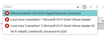

Before opening the PLCnext Engineer software, connect the PLC to the PC using an Ethernet cable plugged into the X1 slot on the controller. The software scans any active network cards on startup, so if you plug in the cable after starting, the software might not consider the Ethernet as ‘active’ as you can see from the red X icon in the Ethernet connection below. Simply restart the software if you encounter this.
Troubleshooting network adapters in PLCnext Engineer

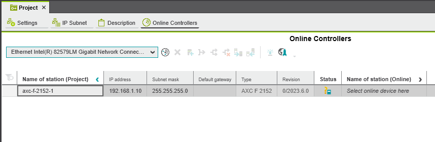

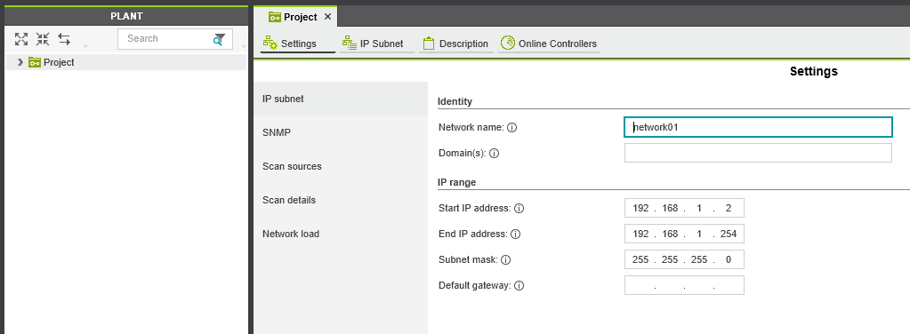

  1. In ‘settings’ ensure that the range includes the PLC’s default 192.168.1.10 and be sure that your PC is set to the same subnet but different IP, such as 192.168.1.20.
    IP Address Range
  2. In ‘Online Controllers’ choose your Ethernet adapter and click scan the network
    Browsing the network for controllers

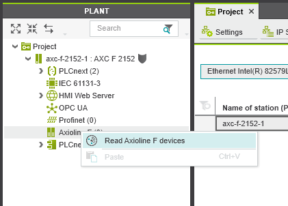

Once connected, right-click on ‘Axioline F’ and scan for modules. The list should include any modules in your current hardware setup.
Reading Axioline modules

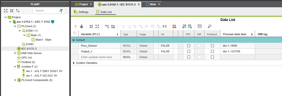

Adding Variables to PLCnext
It’s fairly simple to connect variable, or tag names to I/O points. Double-click on ‘IEC 61131-3’ and open the ‘Default’ variables menu. Add names (I used a simple optical proximity switch, and I’m only using the LED on the output module to show successful program execution).
Global PLCnext variables
In the ‘Process data item column,’ choose IN00 for the first input terminal, and OUT00 for the first output terminal.

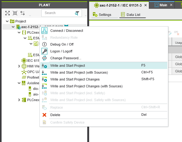

Now, it’s time to right-click on the axc-f in the project, then ‘Write and Start Project’!
Downloading project to controller

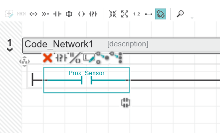

We need to write the code that will activate the output. I have chosen ladder logic due to its familiarity in the field, but all IEC 61131 languages are supported.

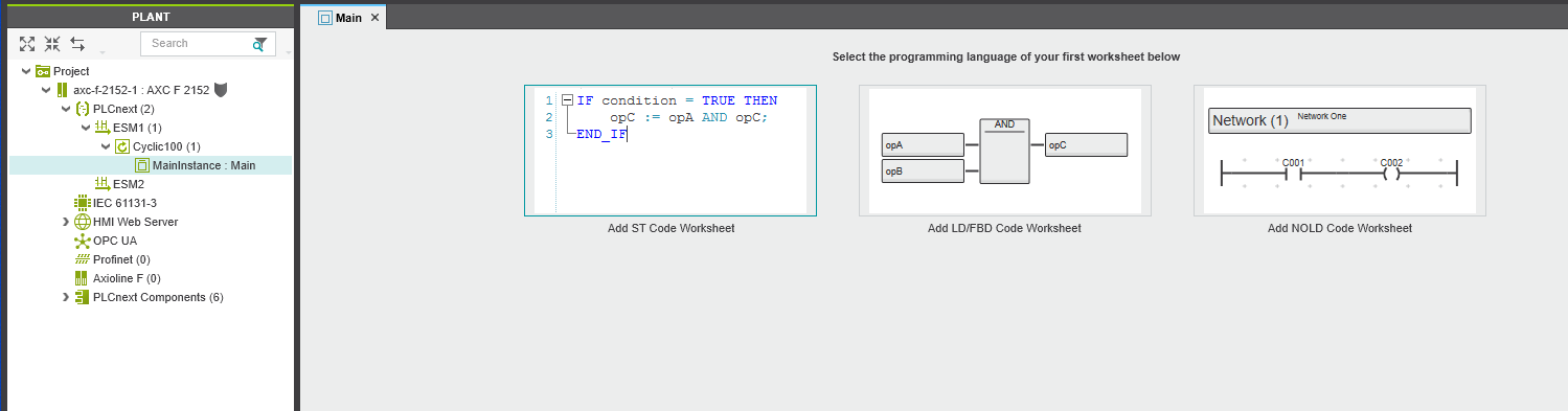

Open the submenu under PLCnext on the left sidebar until you reach ‘MainInstance : Main’ and double-click. We will be presented with a set of options for a programming worksheet. I have selected the ‘network-oriented ladder diagram’ or ‘NOLD’ code worksheet for my example.
Creating a new worksheet in IEC 61131 languages
We are presented with a simple contact and coil. Each one can be assigned the variable name that we chose earlier, either by typing it directly or using the drop-down menu. We’ll choose ‘Prox_Semsor’ for the input contact and ‘Output_1’ for the coil. If you chose your variable names differently, that’s no problem, use those names.
Ladder instruction with input variable
