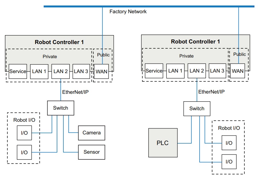

Robot as the I/O Controller
The design of your robot end effector I/O will depend heavily on the company or customer you are working for. Some people have very strong opinions as to who should own the I/O. One method is to order the robot with a master/slave adapter and have the input/output modules mapped directly to the robot.
Figure 2. If the robot is the owner of the I/O, all hard-wired or networked I/O for the cell is driven directly by each robot. Image used courtesy of ABB

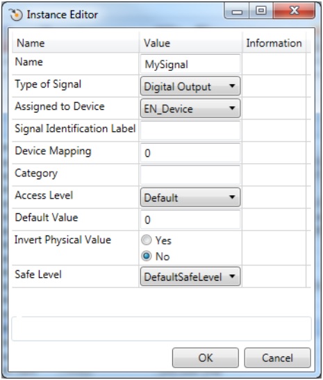

In this method, the robot is said to ‘own’ the I/O and the PLC will not be aware of any I/O state, except what is explicitly sent over the fieldbus network to the PLC address. Each robot manufacturer has a slightly different method for mapping devices through the Fieldbus technology, but is similar to how you would add devices to a PLC ethernet map.
The scanner will need to have an IP address assigned to it, and each device on the network will also need to have an assigned IP address. The amount of data transmitted between the adapter and the device will also need to be specified. Input and output devices can now be added to the adapter and mapped within the program. An EDS or GDS file can also be uploaded to the robot to make this process easier.
Essentially, we are creating an isolated network between the end effector and the robot. This mini-network can have a different subnet than the rest of the machine which can save on IP address if required.
Figure 3. An example I/O signal in ABB robotics software, configuring a digital output on the EN device (an internal Ethernet scanner). Image used courtesy of ABB

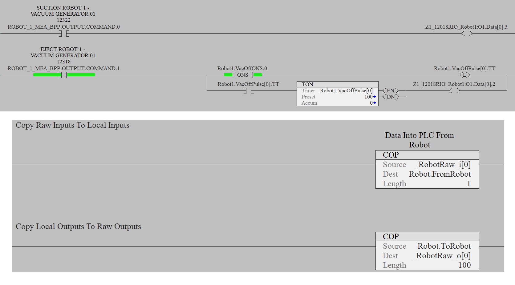

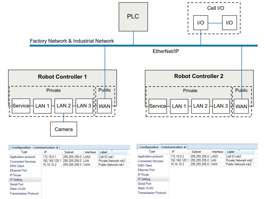

Another method is to set the robot as just another node on the same network as the PLC and add the end effector devices to the PLC network. This method requires all the input and output signals to go through the PLC using the selected Fieldbus protocol. A spreadsheet is often used to track the function of each bit in the protocol map. For example, when the ‘gripper closed’ request bit goes HIGH, the logic in the PLC will fire the output to the valve bank on the end effector. This method might seem a little long-winded, but there are some compelling reasons for this strategy.
Figure 4. PLC-owner network layout, with the PLC, cell I/O, and robots connected to the same factory network. Image used courtesy of ABB

Figure 5. If the PLC owns the I/O, the PLC sends the commands, and then simply informs the robot as to when the I/O signal has reached the destination. Image used courtesy of the author

Considering the robot as the I/O owner will require more faults to be generated, so a special override background program will need to be generated, and status bits of the I/O plus the communication of the module will also need to be added. If the PLC owns the I/O, the robot can simply wait for the PLC to report the correct end effector state. Standard faults can be generated and transferred to multiple projects.
