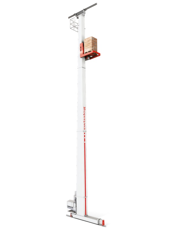

Unit-load Automated Storage and Retrieval Systems (ASRS): Crane
These systems are designed to handle large and heavy products, starting at 1000 lbs, up to 6000 lbs in particular applications. The most common type of unit load is pallets, but large boxes and containers can also be stored.
The infrastructure consists of several tall racking structures and narrow aisles in between. The rack beams are spaced out vertically to accommodate the pallets, creating individual storage cells. Storage cells may be single deep, double-deep, or multiple pallets deep.
Figure 1. A unit-load ASRS from Swisslog. Image used courtesy of Swisslog
The storage density and cell depth are different for each application and depend on various factors such as variety and rotation of stock-keeping units (SKUs). The spacing from one rack level to another may be different; if it is the case, pallets of different heights will be handled in a system, and this distribution makes sense for the logistics.
Fixed-aisle Unit-load ASRS
The storage and retrieval tasks are executed by an automated crane that can move along the X and Y axis inside the aisles. The crane is equipped with attachments that extend in and out along the Z-axis to drop and pick pallets from the storage cells.
In some systems, there is a crane for each rack aisle and inbound and outbound positions at the ends of the aisle. This is called a fixed-aisle unit-load ASRS.
Movable-aisle Unit-load ASRS
On the other hand, a system where a crane can move laterally and change rack aisles is called movable-aisle unit-load ASRS.
Normally, fixed-aisle systems are chosen when high throughput is required. Movable-aisle systems are comparatively slower but less costly and require less maintenance due to less automation equipment.

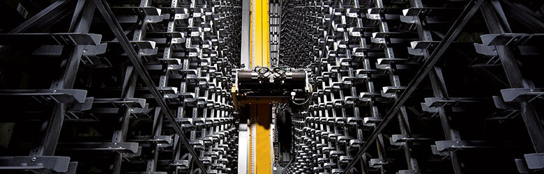

Mini-load Automated Storage and Retrieval Systems (ASRS): Crane
The word “mini” here refers to the size of the load handled and not necessarily to the size of the warehouse system, although they typically are smaller and not as tall as unit-load ASRSs.
Figure 2. A mini-load ASRS from Conveyco. Image used courtesy of Conveyco
Mini-load ASRSs are meant for storing items in totes and trays (i.e., smaller products), and in many cases, pre-assemblies and other work in progress (WIP) materials. The logistics and automation are similar to unit-load systems, except for the design of the carriage attachment for handling totes and trays.

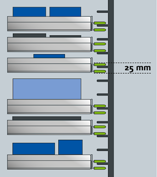

Vertical Lift Modules
Virtual life modules (VLMs), as the name indicates, are modular. These are enclosed systems that serve a specific function within a production or warehouse facility. VLMs consist of two tray columns and a device that moves up and down the columns to extract items and then send them to a picking station.
Figure 4. Rendering of a vertical lift module. Image used courtesy of Kardex Remstar [PDF]
These systems are widely used for storing and immediate access of change parts in a manufacturing setting. Besides floor space optimization, one important advantage of VLMs is that they can be integrated with higher-level applications, such as the ERP, to automatically track item inventory levels and consumptions.

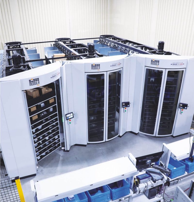

Carousel-based Automated Storage and Retrieval Systems (ASRS)
In carousel-based ASRSs, it is the storage locations that move. These systems consist of automated carriages that can store bins, trays, and boxes. There are carousel systems where the carriages move vertically and others where they move horizontally. The vertical configuration is preferred in facilities where the ceiling is high (12 ft or higher).
Figure 5. A horizontal carousel-based ASRS from Modula. Image used courtesy of Modula
On the other hand, horizontal carousels are more suitable in facilities where the ceiling is low (12 feet or less), but higher throughput is required. They also provide easier emergency access to items in case of a system failure.
