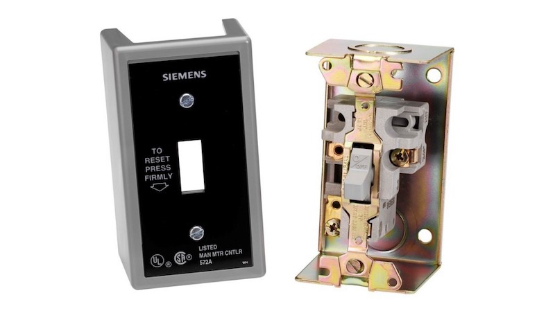

Figure 1. A manual/switch motor starter. Image used courtesy of Siemens
On a basic level, a motor starter will allow current that exceeds the circuit breaker or fuse rating for a short period, until the motor is spinning at a nominal rate. The starter can also allow the motor to be started in the reverse direction.
Types of Motor Starters
Manual: A manual starter is the most basic starter. It is essentially a switch with overload protection. This starter style is only used on lower horsepower motors and only with motors that are not physically restricted when starting. A motor that drives a flywheel, for example, would not use a manual starter, but a pump could use one.

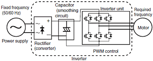

Variable frequency: Using a variable frequency drive (VFD) to start a motor is likely the most efficient way, because of how a motor works. The magnetic strength is directionally proportional to the voltage divided by the frequency.
And, the speed of a motor is proportional to the frequency divided by the number of magnetic poles.
These equations tell us that as the voltage frequency decreases, so does the speed, but the magnetic field strength increases. By starting at a lower frequency, we can decrease the amount of current required to start the motor. Most of the other older soft starters use resistance or transformers to lower the voltage. This method converts the excess voltage into heat.
Combination: A combination starter typically houses not only the starter components but also a circuit protection device, fuse or circuit breaker, and the overload device. This style of starter is a great way to save some space in the electrical cabinet.
Figure 3. A diagram of how an automatic inverter works. Image used courtesy of OMRON
