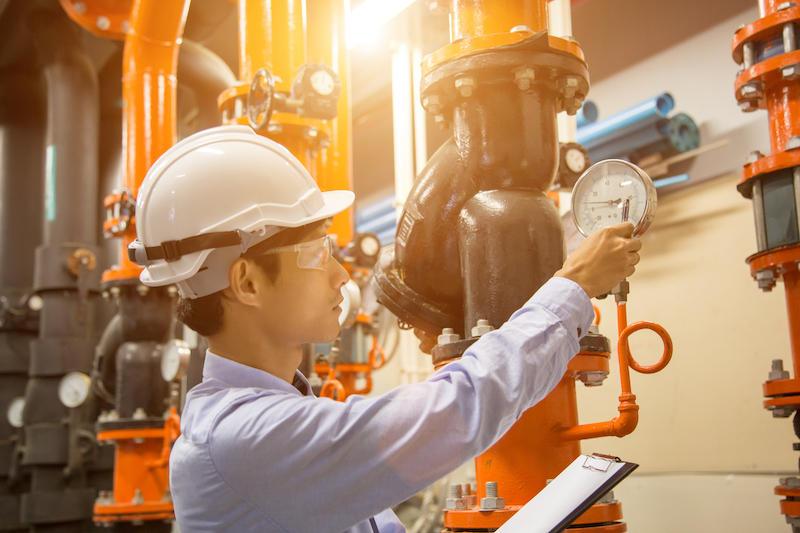

Figure 1. An industrial engineer checking a condenser water pump gauge.

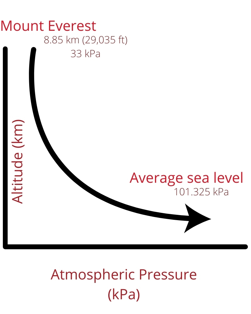

Atmospheric pressure and altitude
Figure 2. An infographic showing how atmospheric pressure changes depending on altitude.
In terms of actual hardware, the matter is even muddier. Some gauge pressure sensors simply subtract out atmospheric pressure mathematically, and others are open to the atmosphere to compare the actual atmospheric pressure to the process.
At sea level, in stable weather conditions, there is no difference between these methods. However, if the gauge is used at higher altitudes or in various weather conditions, subtracting the standard pressure may not accurately represent the conditions.
It is worth comparing the sensor to known standards under several weather conditions to see how the particular sensor operates. Also, to differentiate between absolute and gauge pressure, gauge pressure is often specified with a “g,” such as “38.25 psig” for gauge measurements and “38.25 psi” for absolute measurements.

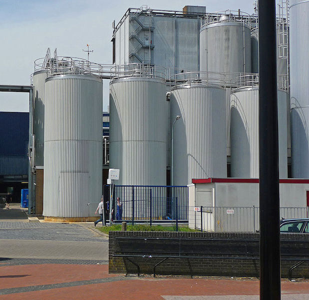

Besides gauge pressure, differential pressure measurements are useful for comparing two pieces of a process. For example, in a dairy, certain parts of the process must be pressurized to avoid contamination moving backward into the milk. If the good milk is at a higher pressure, then even if a valve leaks, contamination will not flow from a lower pressure area to a higher pressure area.
Figure 3. Differential pressure between processing units is frequently used in food processing to prevent material backflow, leading to contamination, or extending residence time past safe limits.
This is also used in semiconductor and medical cleanrooms. The cleanroom is at higher pressure, helping to keep dust and debris out of the room, even when someone enters the cleanroom. In all of these cases, the gauge pressure of one part of the process is not as important as its pressure relative to another part of the process.
