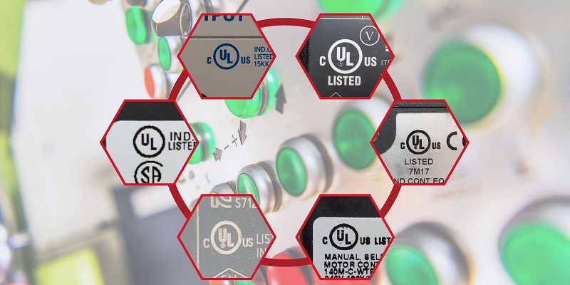

UL Listed devices are deemed safe in North America
Figure 1. Devices such as switches, breakers, contactors, and controllers are UL Listed, which means they have been tested and deemed safe to sell in North America, specifically, in the US. Image provided by Control.com

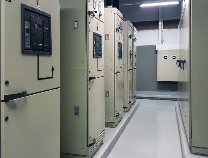

UL Listed products ensure worker safety
Figure 2. UL Listed products help to ensure worker safety, whether it’s electrical or safety equipment. Image used courtesy of Canva
