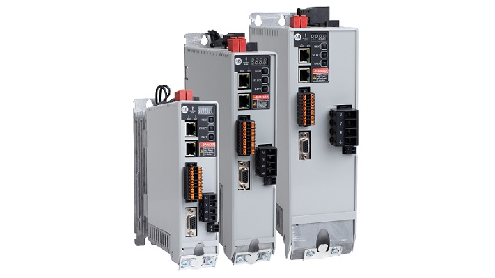

Kinetix servo driver series example of system containing safe torque off (STO)
Figure 1. Rockwell Automation’s Kinetix servo driver series is one example of a system containing safe torque off (STO) signals. Image used courtesy of Rockwell

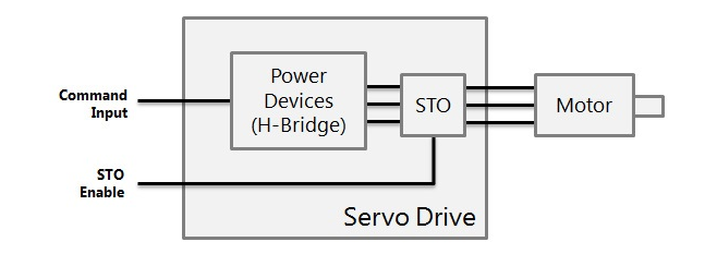

An STO signal is typically a 24 Vdc signal that comes from a control system like a PLC or safety relay. It can be a single or dual signal that needs to change state together with a small amount of error in timing. The signal tells the motor drive that the system is safe to operate. If the signal goes low at any time (0 Vdc), then the drive will stop providing power to the motor which means the motor will no longer be able to apply torque. Any 24 volt power supply will satisfy the STO requirement, but in order for the system to be deemed safe by third-party safety inspections, the signal will need to be passed through the contact of a safety device or come from a safety-rated output of a safety PLC or safety relay.
logical block diagram of a servo control signal alongsidde an STO signal motor operation
Figure 2. Logical block diagram of a servo control signal alongside an STO signal for motor operation. Image used courtesy of Advanced Motion Controls
How Does Safe Torque Off Work?
The STO works just like the signal from a common button or switch. When the switch is open, the power from the drive going to the motor is physically removed or opened. Removing the power doesn’t abruptly stop the motor but allows the motor to coast without torque. Depending on the friction and inertia of the system, the deceleration time for the motor could vary.

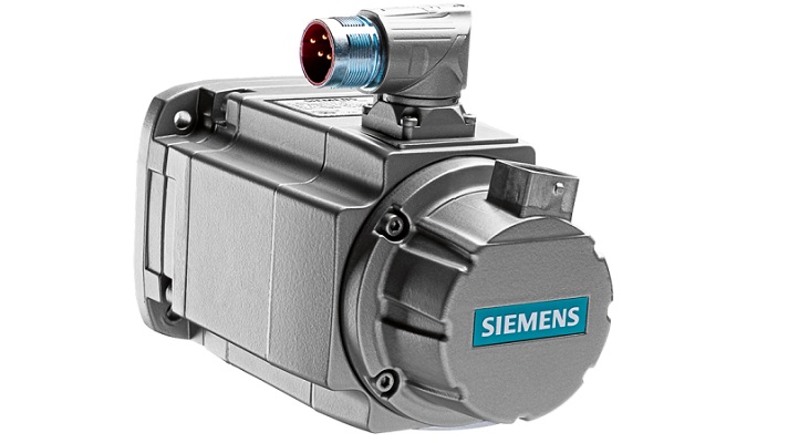

servo motor from Siemens SIMOTICS S line
Figure 3. Servo motor from the Siemens SIMOTICS S line. Image used courtesy of Siemens

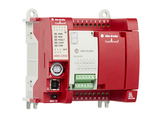

Rockwell Guadmaster safety relays serve as link between end safety devices and controller networks
Figure 4. Rockwell Automation’s Guardmaster safety relays serve as a link between end safety devices and controller networks. Image used courtesy of Rockwell

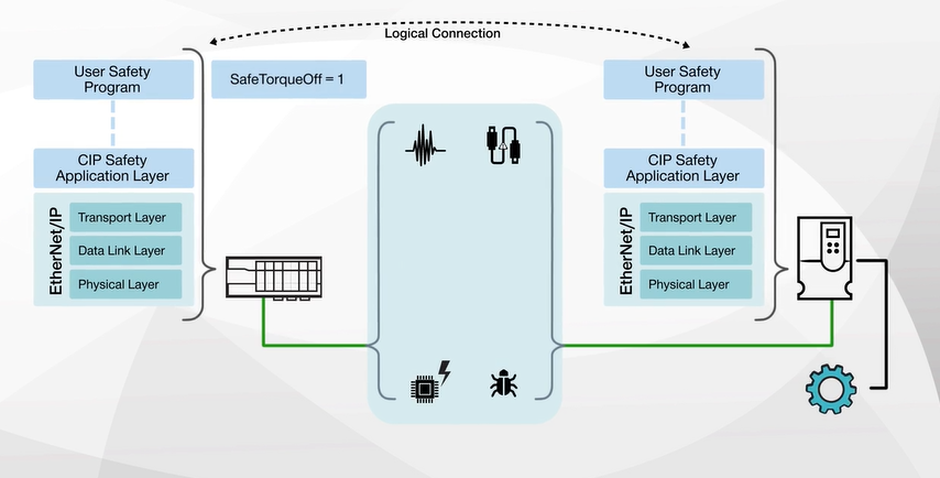

More servo drives are being controlled these days via industrial protocols such as CIP safety or ProfiSafe. These protocols support safety signals to be sent over Ethernet infrastructure, thus eliminating the need for additional safety I/O cards. A safety PLC is required to use this technology. Once the drive is added to the Ethernet device mapping, special function blocks can be used to set the STO signals when conditions are safe.
safety and STIO signals transported using industrial protocols visual explanation
Figure 5. Visual explanation of safety and STO signals that can be safely transported using common industrial protocols. Image used courtesy of ODVA
