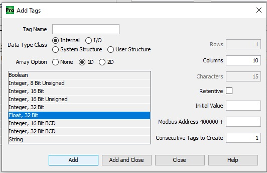

The process of creating an array. All PLC programming software is capable of creating arrays, the software shown is Productivity Suite from Automation Direct.
The second part of the array is the index. The index is the unique way of identifying which of the individual tags within the array is meant to be used. In more generic terminology, the individual pieces are not called tags, but rather elements.
In summary, an array consists of a defined number of individual similar tags or elements. Each element has the same name, followed by a unique index number, always in brackets [ ], braces { }, or parentheses ( ).

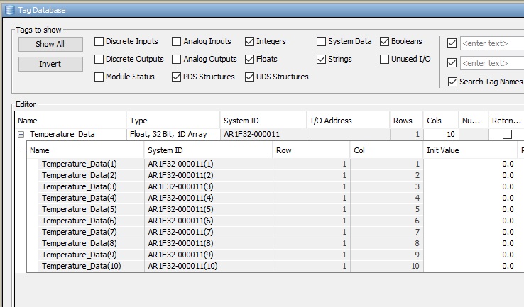

As mentioned before, the nature of the information contained in array elements should be similar. If we have a selection of temperature sensors along a process, the temperature values can be stored in an array. The benefit of this strategy could be displaying any of those temp values on an HMI.
Simply change the number of the index and that temperature will display. If they were contained in unique tags, you would need to change that tag name reference in the HMI to retrieve the data — more difficult than a numeric change of index, and extremely difficult if you need to change the process and add new tag names.
A tag database showing an example of an array "Temperature_Data" and the corresponding tags inside the array. They are indexed with parentheses, (1) etc.
This strategy has another side benefit of saving memory in the HMI. Again, we do not need to create a whole bunch of tags in the PLC and in the HMI — only the array in the PLC. Then the single task required of the HMI is to change an index number to ‘point’ to one of the array elements in the PLC.
