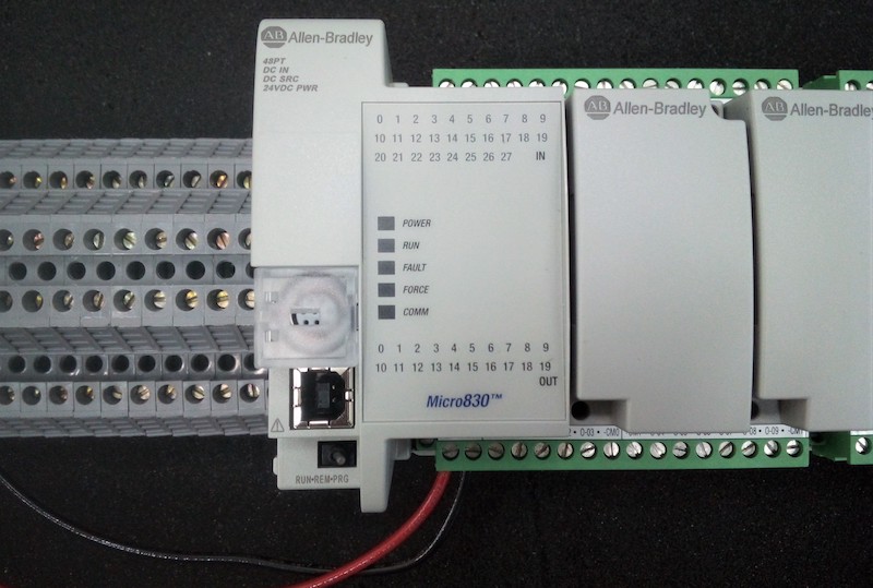

allen bradley PLC
Figure 1. An Allen Bradley Micro 830 PLC. This processor is capable of storing up to 20 kilobytes of data, limited enough that understanding of data consumption is very important.

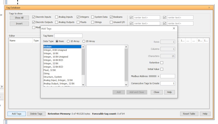

A sample of data creation from Automation Direct.
Figure 2. A sample of data creation from Automation Direct. A listing of possible data types can be seen on the menu.
There is a final category —those with decimal points — that is best addressed separately. These are often called ‘float’ or ‘Real’ and are commonly attached to analog inputs. They still consume 32 bits, but the structure is different and might confuse the subject of integers which is the purpose of this article.

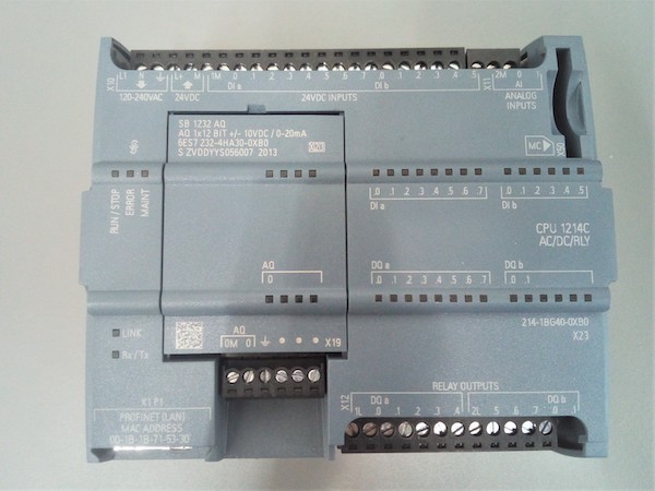

A Siemens S7-1200 PLC
Figure 3. A Siemens S7-1200 PLC. This processor is 32-bit and has a maximum active program (work memory) size of 100 kilobytes — not a lot of space to spare.
