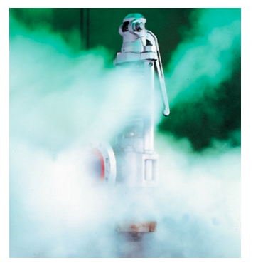

Safety valves are the major safety component installed on a boiler. Their basic function is to release the pressure built inside the boiler when it exceeds the boiler’s maximum pressure value. This abnormal pressure occurs when other safety functions do not work due to failure.
Figure 2. A steam safety valve in action. Image courtesy of Emerson.
The safety valves’ design is according to the pressure that the valve can withstand, often called rated pressure. If the boiler’s pressure becomes greater than the rated value, the safety valve opens, releasing the pressure until it falls back to the safety valve’s rated pressure.
The safety valve requires calibration at regular intervals to test and verify proper operation. This calibration also ensures it is satisfactorily working if an emergency is not necessarily related to the boiler system itself, such as a natural disaster.

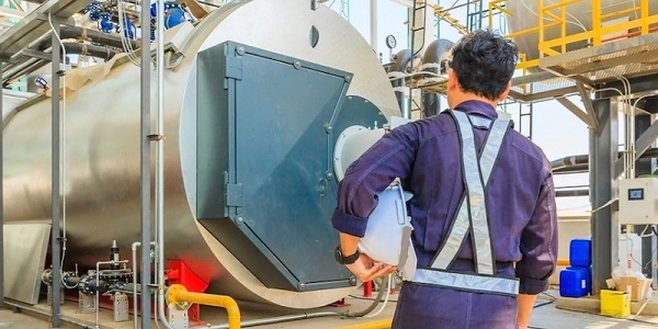

The flame safeguard system’s purpose is to detect the presence of flame continuously. If a flame is not detected, it shuts off the fuel supply.
Figure 3. Flame safeguard systems detect the absence of a flame. If the flame is not present, the system shuts down the boiler. Image courtesy of Siemens.
If no flame is present, a large quantity of fuel collects in the burner. In large enough quantities, this accumulated fuel could cause the furnace to explode. If the flame reignites after a prolonged period, the boiler could explode due to the large amount of deposited fuel.
