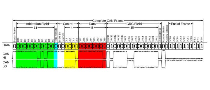

Since it’s a ‘standard’, the rules of CAN bus dictate a few elements: the voltage of the signals, the speed of data transmission, the direction and coordination of the signals between devices, and the structure of data and device ID sent down the wires.
The final purpose of the signals is absolutely not defined by the standard, so it makes a good platform to connect various sensors and devices which are sharing totally different kinds of data. The CPU must figure out what to do with the data it receives from each device.
CAN-Frame in base format with electrical levels without stuffbits
Figure 1. CAN-Frame in base format with electrical levels without stuffed bits. Image courtesy of Endres [CC BY-SA 3.0]

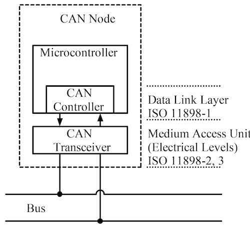

An auto mechanic will readily recognize the common four-wire connections that are used in many vehicle sensor applications. O2, thermal, crankshaft sensors, and many others will contain those four wires. These consist of power and ground, as well as wires that will be named high and low, sometimes CAN high and CAN low.
In comparison, DeviceNet also has a power, ground, and high/low set. In addition, they may contain a shield ground for noise immunity, which is always a legitimate goal.
The two wires are referred to in this case as a differential pair. This provides greater immunity against noise. A terminating resistor is usually located in each node (device) or at each end of the wired network — again, similar to the terminators at the end of a DeviceNet trunk line. This resistance prevents signal reflection which can distort the signal and slow down communication since a re-send of the data is necessary.
can bus node
Figure 2. A diagram of a CAN bus node. Image courtesy of EE JRW [CC BY-SA 4.0]
In a CAN bus network, each device is monitoring the line and sending data in a sequence. Every device has a built-in ID which is not only contained in the data transmission but also contained in the CPU of the device so that each device does not "talk over" the others. Imagine a group of radio operators conducting a check-in. One person can conduct the roll-call. This is called polling. In the case of data like in a CAN system, each radio operator has a number “Person 1, checking in”, then “Person 2, checking in”. This is called sequential arbitration.
